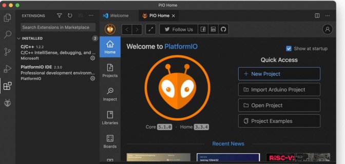

Installation
1) Get Visual Code Studio. It’s free and open source.
2) Go to the extension library (the 4th icon on the sidebar), search for PlatformIO and install it. Congrats you have PlatformIO installed.
PlatformIO main page
PlatformIO adds a purple/blue toolbar to the bottom of the window. The home button opens PlatformIO.
The main page allows to browse all your projects, create new ones (even import Arduino ones), browse libraries and find documentation about boards.
