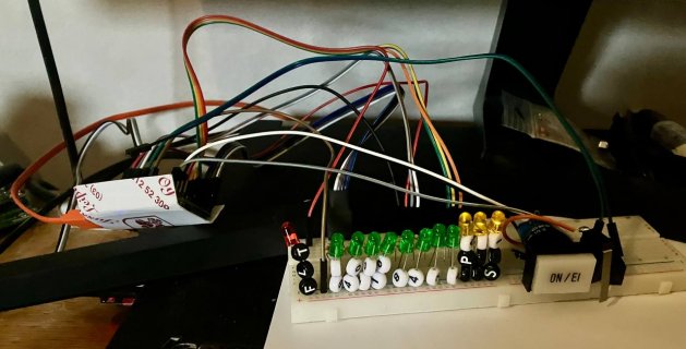

Someone asked me whether I'm debugging this with JTAG or OpenOCD+gdb. I'm not sure whether or not to send the attached photo to them.

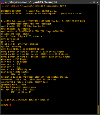

Now we are booting to multi-user mode, need to hook up another UART. Repository needs attention, I've been hacking together horrible code to get to this point, general idea being "I'll clean it later". There's a slight glitch in the UART driver still - I have hooked up a button to the board so I can manually trigger interrupts for debugging - turned out that pushing the button is required to get it to go multiuser. I think the culprit is in my uartopen(), need to look at how it is supposed to be done.
The two weird printouts are the debug strings printed by the interrupt handler, showing current systick count and swapin/swapout activity from last five seconds.
