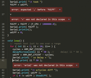

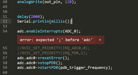

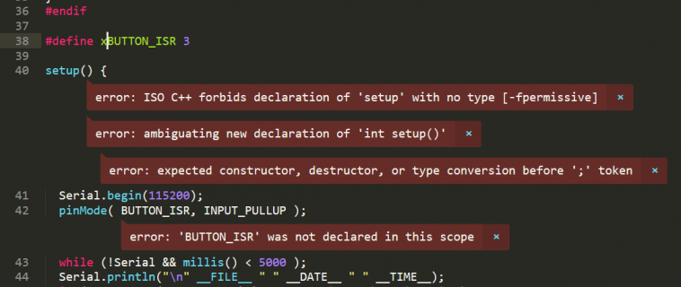

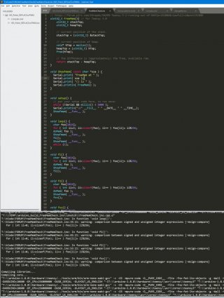

Using Frank_B's Compile.cmd with needed local system edits ON WINDOWS I got this working on my current sketch.
<edit> copied Compile.cmd to second sketch folder and from SublimeText3 it worked there as well, and it prompts on first use of Ctrl+B
Add this to SublimeText : C:\Users\yourNameHere\AppData\Roaming\Sublime Text 3\Packages\User\Teensy.sublime-build
{ I got this with answer found here : stackoverflow … how-to-compile-and-run-c-in-sublime-text-3 :: see '1. Create a new build system in Sublime: Tools > Build System > New Build System...'}
Using 'tools / build system / Teensy' then Ctrl+Shift+B allows selecting the desired compilation type: 1,2,3.
Once one is chosen hitting 'Ctrl+B' will rebuild with that option.

Edited below to get the TEMP files INTO the temp directory rather than at ROOT:
set temp1="%temp%\\arduino_build_%sketchname%"
set temp2="%temp%\\arduino_cache_%sketchname%"
Also there was a forward slash here made to \:
"%temp1%\%sketchname%.%model%.hex"
