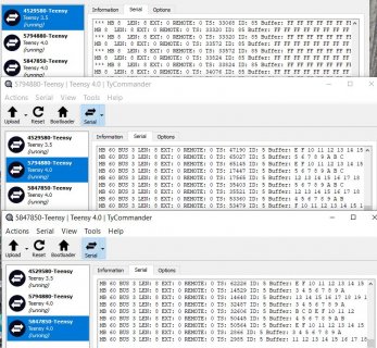

    @defragster
    Just for the fun of it I ran a test with T4-T4-T3.6 with the T4's in legacy mode on CAN3 going to CAN0 on the T3.6. The sketches ran without a problem:
