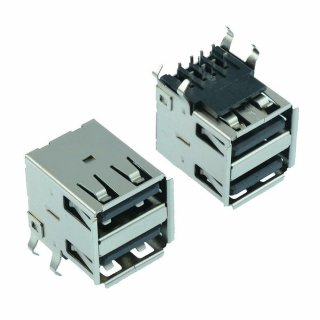

T4.1 USB host - dual port?
Indeed, a hub on USB host is supported, and if powered allows more and high current devices.
Not sure what those USB parts shown are? Looks like they are just two USB device sockets wired with connections for each?
I might be wrong, but as far as I know the T4.1 does not have a built in USB HUB which is what you would need to use those connectors. As @defragster stated above you just need an external USB HUB connected to the T4.1 USB host port...
Like the others, I am pretty sure that is simply two connectors. that is there are 2 groups of 4 pins, which probably match the 4 pins of our one connector where then the 5th pin would connect up the shield...
If you wanted to use something like that you would probably need to add in a USB hub IC and supporting hardware that then hooked up.
