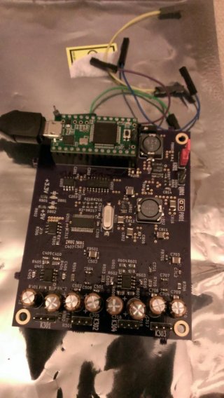

I finally got the rest of the board assembled and was able to do some preliminary testing this evening.
Here's picture of the completed board along with my 'loopback cables' :) (taken with my terrible cell phone camera):

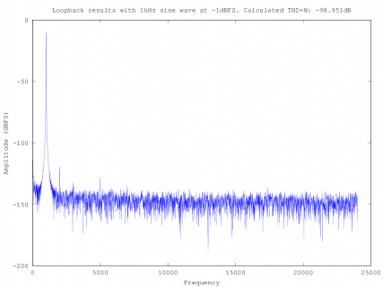

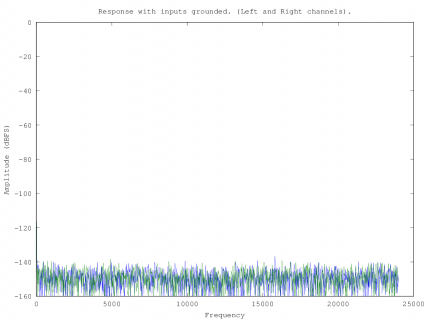

Input noise with inputs grounded (4096 pt capture, no averaging):

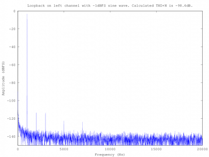

Loopback with -1dBFS sine wave at 1KHz (8192 pt capture, no averaging, left channel only):
I'm pretty happy with the performance. There aren't any spurious signals sticking up anywhere (even with my cheap loopback setup), and the performance is pretty darn close to the CS4272 specs, as designed.
I'll do some more testing tomorrow, but everything is looking good so far!
@whollender. Looks pretty good.
Since you apply loopback, the ADC and DAC are syncronized, therefore you can choose a 'nice' frequency, so that you can remove the windowing and look also close-in to the carrier. "Nice" frequencies are a multiple of AUDIO_SAMPLE_RATE_EXACT/N_FFT, so 2.69 Hz, so a good 1 kHz candidate will be round(1000/df)*df = 999.002 Hz.
I also notice that you have the carrier at -8dBFS, did you already tweak this for the highest possible dynamic range? Usually ADC's are measured at -1dBFS, although I agree for audio applications a lower value is more representing the typical use.
Edit: one minor thing with loopback is that it does not show spurious effects on the reference voltage.
Edit2: Just noticed that the heading says it was at -1dBFS, so maybe the results were not corrected for windowing loss?
@kpc, I did screw up the scaling (I was up too late and trying to get the plots off before my laptop battery died). The whole plot should be ~6dB higher (forgot to scale for max sin amplitude of -3dB and also grabbed the positive half spectrum without adding in the negative side for another 3dB). I did compensate for window loss.

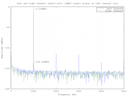

If you would not mind, I would be very interested in three further measurements.
The first one is isolation. I assume you would already be performing this one yourself. Put a sine on the left DAC out and zeros n the right DAC out. Then measure the signal coming in the right ADC.
The second is the noise level with the either inputs open circuited, or loaded with a resistor > 1k.

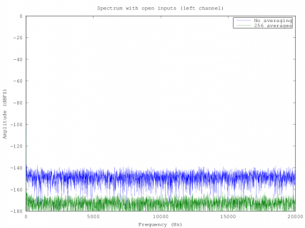

That sounds like a pretty interesting application. Here are some more results:
Left channel with open inputs:

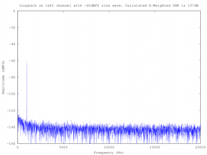

-1dBFS loopback with synchronous fft:
-60dBFS loopback with synchronous fft:
Isolation test (-1dBFS 1kHz sine wave on left channel, measuring left and right channels on input, with 256 averages):

I added a bunch of averaging to the two tone and isolation tests so that the peaks were clear of the noise floor.
The SNR is a bit lower than I had hoped, but the noise for the input and output are adding, so it should be about 3dB higher individually (assuming the noise amplitudes are the same input vs output). If you add 3dB to the dynamic range, it's about 110dB, which is pretty close to the claimed 114dB on the CS4272 datasheet.

I have to say, I am impressed with the results.
Just cross-checked the harmonics with the intermods and they seem to be consistent.
Also the 5th and 7th harmonic is pretty dominant, so the cause might not be nonlinearity in the amplifiers/S&H, but in the actual A/D converter itself. Also now by checking the datasheet I see that the THD does not track the input power, which is another indication. Anyway pretty decent results.
As to the dynamic range, the 114 dB in the datasheet is A-weighted. I would suspect you are using unweighted results, so if you compare this to the 111 dB in the datasheet, you are pretty close. As to the 3dB increase, just by eyeballing, this is a reasonable assumption. When I check both the open and short circuited noise floor, then the loopback seems about 3 dB higher, so you are probably not too far off.
Thank you whollender for these measurements.
Edit: Oops, I now see in the heading of the figure, that you used A-weighting.

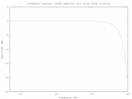

Next up is a frequency response test, and some testing at higher sample rates.

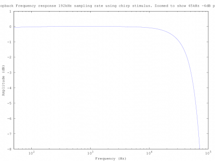

192kHz sample rate works! The mk20 chip doesn't specify it's I2S interface very well, so I wasn't sure if it would work with the isolator ICs slowing the interface down.

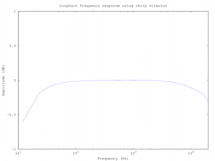

Here are a couple of frequency response plots:
@ 48kHz sample rate:
@ 192kHz:
@ 192kHz zoomed to show -6dB point (-3dB for input and output, assuming same freq response):
