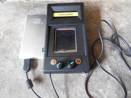

Hi
AS requested a photo of my build. I use an external PSU, easy to change if it runs out, less electrical noise in the case. Case was one I had spare from a previous project. DSCN1499R.jpg
I plan to offer one box to a friend*: Thus I need a short manual. Please use doc 2003 win version or same in Libre office under Linux:easier to modify for every body if you want to add your information, correction

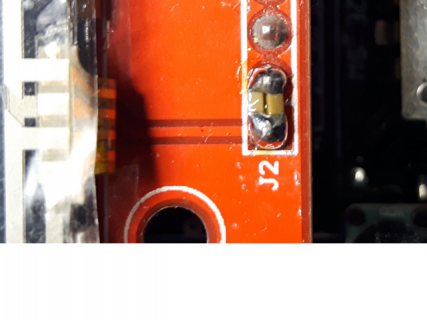

Hi Rémis,
I think I remember you said adding a capacitor between the 3v3 pins on the audioboard and some pins on the TFT screen helped reducing noise.
In the past I tied to reduce noise but most seemed to be data and clock signals to the TFT signals that were not so easy to reduce.
Can you tell me on wicht pins of the TFT screen you added what kind of capacitors?
Kind regards,
Edwin
decoupling
To add detail message #316:
I improve decoupling with 470nF 0805 ( or 0603 ) : They are soldered directly beetwen supply pin and groud. It could be the next pin, (if pin is gnd) or i use the ground plane. For TFT I add capacitor on your PCB and directly on screen side. See pictures, with two differents capacitors. You can do that for all VCC, 3V3 signal. Without microphone and wire input connected you should have a flat spectrum. If yes you have validated the correct decouling : there is no more perturbation in conducted mode.
