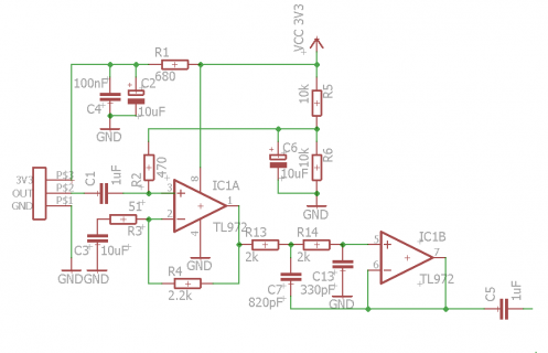

Edwin,
The problem with using the smaller value caps is that it increase the impedances seen throughout the circuit and will produce more noise. Same for reducing the values of the feedback and shunt resistor. Resistor noise increase with higher resistance.
I would try the circuit as I outlined and worry about low frequencies later. Your cone is going to give you gain at HF by producing a more cardioid pattern, but will likely cut-off rather steeply below 15-20k. This may be sufficient to allay your concerns regarding low frequencies. If necessary, you can decrease the value of C3 to produce a LF rolloff. The lower value you chose for R2 is reducing the mic output several dB.
I have used the 6203 considerably, but the 4841 is pretty sweet and has lower noise and way more gas available at high gains/frequencies than the 972. I plan to use an SOIC to dip adapter for the board. I use the SOT23-5 package a lot.
Consider the following:
Edit your schematic with the values I indicated in previous post.
Move the entire first opamp section's circuit to the left a bit and the serial connector down to make way for a second order low pass using the second opamp section.
Move R2 so that it extends upward from C1 and connect its upper most end to VCC/2. You might consider adding the additional resistor and decoupling cap as discussed in series with VCC/2 and the top of R2.
The second stage is now down there clear of obstructions/connections. Move it over directly under IC1A and down a little bit (that's why the serial connector needed to be moved)
Connect two 2K resistors in series, placed horizontally to the left of IC1B. The free end of the rightmost resistor connects to pin 5 (the + input) of IC1B.
Connect pin 1 (IC1A output) directly to the leftmost end of the left resistor in the series string added to the IC1B + input (disconnect pin 1 from C5 as well).
Connect a cap (820pF) from pin 7 (IC1B output) to the junction of the two series resistors (place it over the top of IC1B).
Connect another cap (330pF) from pin 5 (the +input) to ground (move the series resistors left as needed to make room for this cap).
Connect pin 7 (IC1B output) to the left side of C5.
Leave the pin 7 to pin 6 connection as drawn (as a voltage follower)
You now have a second order unity gain LP filter in series between the preamp and the 5000 input. The -3dB point is around 160k and is fairly steep.
Make it look pretty and post it if you have the time.

The problem I see is that when the reed relay is open, so is the input to the circuit. With no low impedance source connected, the noise floor is going to be very high. Connect a low value resistor (10R to 51R as mentioned) across the detector's input. That way when the relay is open, the input sees a low impedance path to signal ground. With the 10R (and your 50 ohm source), you'll have to crank up the output of the DDS 15dB or so but you will get better measurements.

@aethertek
did you say a picture is worth a thousand words?
would you mind to draw your schematic suggested in #495?
Well I do hope your 1000 words are all in this picture....
Probably missed something.... I don't like the 2k resistors by the way, I have all E12 resistors so 2k2 would have suited me better :)
Please let me know where I messed up (or did not)
I just read the previous posts, did not realize any of you was talking about pictures and a thousand words, did not meen to offend anyone.
spice does show this seems to give the described effect, I was just wondering though, would it not be better to filter before amplifying?
Edwin

Come on you guys, you're dealing with an old fart who has little time on his hands. Please give me a break...
Edwin,
Everything is correct except R2 should be 10K. Your gonna' lose about 6dB from the mic with that 470R (and the added loading will increase the mic's THD).
Other comments:
Leave a placeholder cap at the original (old C2) position. May need it later for RF.
Put the 22pF (old C4) back in across the feedback resistor (new R4). May remove or increase it later (some performance is layout/strays related and you want to be able to compensate).
Is VCC/2 used anywhere else on the pcb? If so, add a 1K between VCC/2 and the supply side of the new R2. Add a 10uF decouple cap to ground at the junction of the two resistors. If VCC/2 is not used anywhere else, you're good to go (just rem to change that 470R R2 to 10K).
Add a 10R resistor between C5 and the DAC input. May not be needed but again, sometimes helps with RF/spikes.
When I build mine (soon I hope) I will likely build this entire circuit on its own PCB. I may add another second order, i.e., make it a fourth order LP, if needed.
I will also separate power and signal grounds so I can play around with various ground schemes to eliminate any ground/ground loop related noise and THD (the opamp and DAC supply currents are typically very non-linear and if any ground Vdrop leaks into the signal path, THD goes up).
And so it is, just as a picture is worth a thousand words, a thousand words can also be worth a picture...
