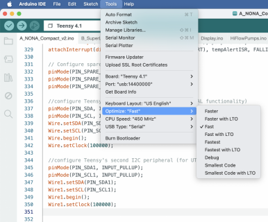

Boot loader blinks 9 times
I have an original Teensy 4.0 that I just pulled out of the bag and soldered wires to 3.3V, GND, and A0. When I first powered it up with USB, the boot loader LED came up solid and would not program. I then held the button for over 15 seconds. After that, the loader updated the boot loader. That ended in an error.
Now, when I plug it in, it enumerates OK, tycmd sees it, but if I push the button or try to upload from the IDE, then the boot loader LED immediately starts to blink at a 500ms rate for 9 flashes, pauses for about two seconds and repeats. It also disconnects and requires remove and insert of USB to enumerate.

Have you tried something like a SIMPLE blink sketch - From the IDE with TyComm closed?
Also In the Teensy.exe Loader program under 'Help' is 'Verbose info' - that will detail the events it sees from Teensy. Best to only have the one T_4.0 on - clear the log [it can push out a large log of stuff] - and then repeat the steps to see if anything shows.
Try the restore process, by holding the pushbutton for 15 seconds. Release the button when you see the quick flash on the red LED. The red LED should come on bright for about 30 seconds while it slowly wipes the flash and restores a known-good program. When finished, the red LED should turn off and the orange LED should blink slowly.
Does that work?
Yes, tried that.
Here is the log:

I have an interesting post-script to this Teensy 4.x boot loader 9-blinks symptom:
I'm using bog-standard Arduino (2.3.3) + Teensyduino. Brand new Teensy 4.1, no pins soldered, nothing connected, just bare on my desk.
Been compiling & uploading the beginnings of a large sketch over the past week, mostly consts & variables & typedefs, and the only actively running code currently is the superloop blinking the onboard LED once/second, no issues whatsoever.
Then today I added the I2C Wire. & Wire1. setup lines, per the attached screenshot, nothing fancy.
But on first upload I got the 9-blinks after programming!
Found this thread, nothing obvious applied to me (I had to google what TyCommander was).
Wondered if me not having any pull-ups on the i2c lines was causing an issue, so I added four 4k7 pullups. Still no joy.
ANY call to even just one of the Wire. (WiresetSDA/SCL, or Wire.begin, or Wire.setClock) library was causing the 9-blinks.
Dunno what made me check, but in Arduino's Tools > Optimise I'd selected "Debug" a week ago. Changed it to "Fast", and now the 9-blinks problem is gone.
FYI.
Were there any errors or warnings with the Debug build in Verbose mode?
@ALL - was there some recent build note regarding DEBUG - not seeing it in the beta 1.60 threads ...
Nope, zero compile errors for 'Debug' & 'Fast/er/est' (with Verbose on for compile & upload, and All errors).
You might be thinking of a recent fix for USBHost that had some functions not marked as pure virtual, which caused build errors when targetting Debug.
The problem with the Wire library sounds like indeterminate static initialization order which existed for a while when the compiler (part of Teensyduino) was upgraded and some fixes need to be added. Latest Teensyduino most likely will not have the same problem.
