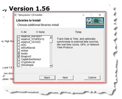

Problem is, it's two years old and is built on Arduino IDE 1.8.6 and the world has moved onto 2.3.2.
He meanders onto the need for https://www.pjrc.com/teensy/td_download.html and the libraries it contains.
Which of course isn't supported on this new version. As you can see from the YouTube link above, he instructs to install Teensy 4.0 libraries that are the same name as Arduino libraries and you need to point the compiler in the right direction after installing them:
But all of this is irrelevant it seems with the new version. Just for fun I compiled but of course it is missing the libraries:
I suppose I could claw my way through the rest of this with a few more hints, or uninstall 2.3.2 and downgrade to 1.8.6 and use the two year old instructions.
I need Audio, Bounce2 and Time. I see libraries here: https://www.pjrc.com/teensy/td_libs.html
All reference using the Installer which won't work on 2.3.2.
Suggestions?

For Arduino 2.x, you don't have to manually download and install TeensyDuino as you do for Arduino 1.x. Instead, you use the Board Manager in 2.x to select the Teensy board package, and it will do the download and install for you. See the instructions at the link below and ignore the fact that the giant title is "Download Teensyduino, Version 1.59". Immediately below that are the instructions for installing the teensy board package in Arduino 2.x. It's just the first couple of steps that are actually related to 2.x.
Good point. I've edited the web page. Title no longer has the word "Download". Added "(Install by Boards Manager)" to the Arduino 2.x.x part, and added "(Download and Run Installer)" to the Arduino 1.8.x part.
I also added words "On Windows 11 laptops a with small touchscreen display, but may need to scroll down to even if no scrollbar appears".
Hopefully these edits help?
