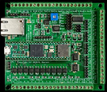

Hi, I have a library that is in my git repository here. Look for teensy4.1.dist.zip. I use this on several boards including one with Ethernet pictured below.

Thank you very much - I like the separate USB Host block and it follows the footprint pins layout
Thanks for the library eagleman! It's working great for me in Fusion 360.

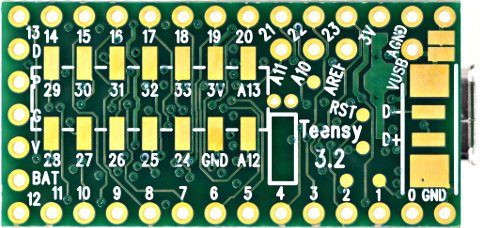

Also look here for some ref: tindie.com/products/loglow/teensy-32-breakout-revision-d/
>> 4× Pogo Pin (Mill-Max 0906-1-15-20-75-14-11-0)
You might be onto something there...
What are the odds that this Teensy 3.2 Reset pad is the same size as the D+ and D- pads on the 4.1?
As long as it is CENTERED and the right Sprung Height - Seems it should work as long as it makes contact with proper pressure

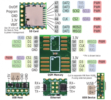

Here is what the T_4.0 Beta looks like - but on that board those are the HOST USB pads unlike on the T_4.1 where they duplicate the DEVICE USB.
In the background are the multiple POGO pins to the group of SDCARD pads and other on the T_4.0 bottom. You can see narrower tip on the SD(SDIO) card pins

You can see the USB pins are stout, the SD card pins are finer pitch and spindly and Paul made the visible plastic support to hold and align them. All those spring pins were enough to raise the Teensy from its socket over time when the headers loosened up. Just two might not cause trouble with tight header fit and no vibration.

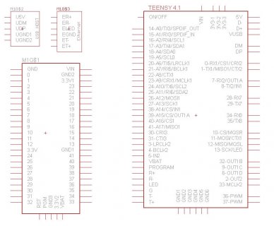

Please check Pin 41; you have it labeled as the alternate pin for MISO1, when in fact that is Pin 39 (check the card).
The .LBR file was downloaded today and generated this result in Eagle:
Hopefully this will save someone else from costly mistakes that have to get re-sent to fab...
