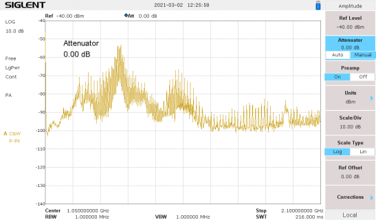

Spectrum from my SSA3021X using small B-field probe 1cm above T4.0:
background level from same probe:
These are 0 -- 2.1GHz range, with T4 running at 600MHz clock.

@Mark: Great! Thank you.
Can you repeat this with FPU usage, and I2S enabled? (don't know if the if makes a difference wether there is a load on the pins or not.. maybe try with audioshield added?)

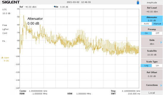

A different T4 with audioshield and HX8357D TFT attached:
I think that one was programmed for 150MHz
This noise is not from the frequency of the CPU, but is more from the edge rate when switching. The RT1062 does have adjustable edge rates, so if you are using a lower switching frequency you can slow the switching speed down to reduce those high frequencies somewhat. If you are switching the pins at more than 150MHz the noise is unavoidable. But for switching speeds below 50 MHz the edge rate can be slowed considerably to reduce the high frequency RF noise.

You're right you can modify the PAD settings. It was done for this test...:)

Still, the noise levels are fairly minimal. Mostly less than -70db above 1GHz, and nothing higher than about -55db. This type of noise is easily suppressible with grounds added between transmission lines.
