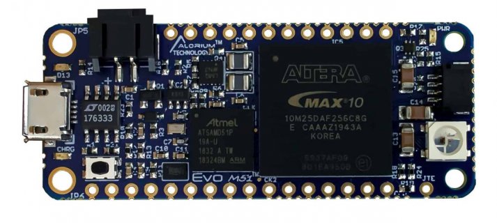

One way to expand the number of pins available would be to provide double-density castellations along the edge. The Alorium Evo M51 does this. Every 0.1" spaced through-hole pin is brought out to a castellation at the edge. Between each of those connections is another pin, for net spacing 0.05". This provides roughly twice the pin count and makes the board surface mountable.
More details on this board here: https://aloriumtech.com/evom51-quickstart/
So, for folks who need 0.1" spacing for breadboards, you've got the regular through-hole pins. If you need more pins or surface mountability, use the edge connections.
Also, with a jig, it's possible solder 0.05" pins along the edge to make it socket-able.
