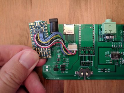

I really like the smaller form factor of the T4.0 - my only request would be easier access to the SDIO pins, but I am managing fine so far. I'd probably be very interested in a 4.1 (3.6FF) variant it anything became available.
