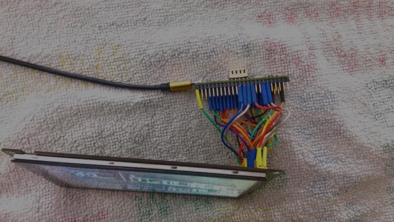

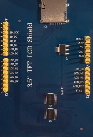

Found the problem.
I was able to confirm the upper 8 bits were not being set be using "p->SHIFTBUF[0] = 0xFFFF", then measuring the pins with a multimeter. Lower 8bits read 3.3v, upper 0.3v. This suggested a config issue. Had a look at FlexIO_Config_SnglBeat() where I noticed "FLEXIO_SHIFTCFG_PWIDTH(7);". That's the problem!.
R61529 is now fine with the 16bit writes. Time to try the RM68120.
Oh! I always miss something haha
So the RM will only take a max of 20Mhz?
The data sheet says min of 10ns for frequency cycle.. with should be around 50Mhz for a full pulse width.
EDIT
RM is max 33ns between WR cycles
The ILI9806g is 30ns
So a max of around 30MHz for both
Thats around 70ish fps on a 16 bit bus
From my observation, 20mhz was the max under the conditions it was operating. I've since discovered the RM to be quite sensitive to poor grounding, a-lah my setup, which was inhibiting proper timing. Teensy 4.1s have 3 ground pins available, the display has two. I was using a single ground pin, via a Dupont connector, of course. After removing all Duponts, soldering everything directly and hooking up another ground has resulted in a jitter free display, allowing faster clocking.
As for performance. I'm seeing ~32MByte throughput on USB allowing for around ~38-40fps. More than enough.

Yes, DC (which is RS on my unit I believe) to 13, CS to 11 and RST to 12.
Here is a picture of my TFT unit.
I left the F_CS pin unconnected. I don't know what it is for?
All the SD pins are unconnected.
RESET is left unconnected too, but just to be sure I tried to connect that to +5V and to GND but it made no difference.
5V is connected to Teensy 5V line and of course GND to Teensy GND.
I tested continuity between all TFT pins and the Teensy and it is all connected.

Thanks for confirming!
I have the same LCD here so what ever I get working you can replicate!
I need to dig up one of my spare T4.0 and solder on some headers and then I will be able to test as well.
