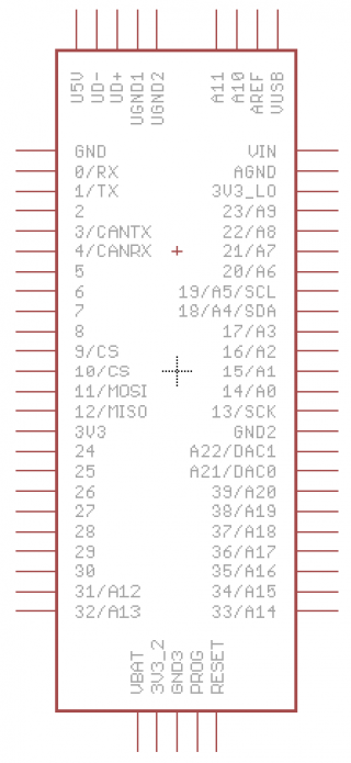

Ok guys this is my prelim eagle footprint, some of the pin functions could be wrong (after #39 they are not confirmed with a pin out card), I left out the alternate pins because there are so damn many of them that its hard to put them all on the symbol. I have not updated this other then to add a warning since last week, I have a lot of catching up to do IRL.
Guys as we find things out let me know and I will gladly update the footprint. The 3.5 footprint should not be to hard I think it will mainly be fewer functions on pins and 5V tolerance.
Prelim!!! Check all PIN Assignments!!!!
Pins after #39 have not been confirmed
as to functions, alternate pin functions not
marked.
Footprint and symbol screenshots for those who don't have eagle or aren't around a computer to look.
Note!!! 3.18mm is actually 3.175mm for the second USB, eagle rounded it
I also have an updated version I am working on.

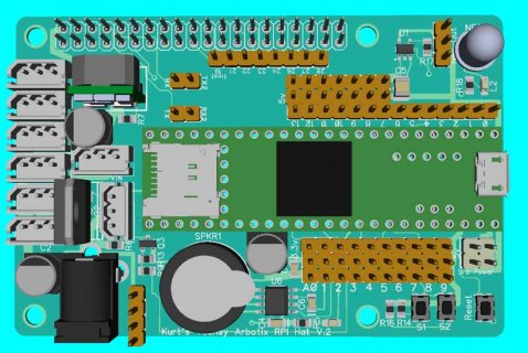

For the fun of it, just starting to play around with my Hat board (that could plug into RPI or Odroid or UP board), to use either the T3.5 or T3.6. Right now just playing around with ideas.
So far I dropped the BNO055 IMU plugging directly into board... I also changed Sound from using simple transistor RC circuit to try out using a simple AMP setup like LM483, with real simple speaker. Still have Neopixel, but may change?
Still want to hook up more configuration/communication options between Main board and Teensy. Like using more shunts to hook up UART between the two (actually still there). But also add ability to connect SPI between the two and maybe I2C...
Right now just getting ideas of space.
For example do I try to add space to back to Teensy for SDCard insertion. Or maybe mount Teensy high enough to go over top of connectors when no wires are connected...
Will create a new thread if/when this goes somewhere.

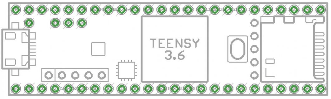

Here are a couple of Eagle devices for 3.5/3.6.
Let me know if anyone has any thoughts on improvements etc
I've listed the different pins but only the primary ones —*for instance only the first channel of SPI and I2C etc — I figure this means you can put it in to Eagle and connect basic stuff up without consulting any board.
Disclaimer — it is totally 100% untested — use with caution!
Moved the file to here: https://github.com/jamescarruthers/Eagle
James

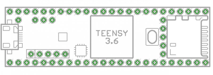

Hi all,
I just wanted to share this —*it's the full pin device for Eagle.
I'm going to make a simplified version too — without the USB host and middle row of pins.
Disclaimer — it is totally 100% untested —*use with caution!
James
Do one without the USB host. I think it's designed for the usb connector to plug into the top of the board.

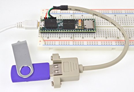

I don't see why you wouldn't break that out to socket? Or are the pins not the standard 0.1"?
They are .1", but they aren't on the same grid as the rest of the board (they are offset .05").
The white line around the holes usually means a connector is plugged into the top.
And there's this picture.
Totally — and it makes total sense when it's on a breadboard — but this is for an Eagle device.
