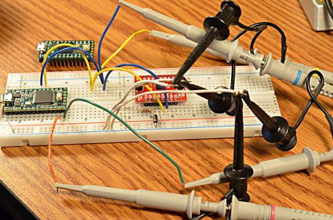

If I am looking at the circuit right you have a resistor going from gnd to 3.3v on one side and a diode from the gnd to gnd. Why - power filter vs using a CAP? I can read the resistor but not what diode you are using. Learning exercise for me on that one?
This raises the BNO080's GND voltage by about 0.4V about Teensy's GND. So when viewing the waveforms on my oscilloscope, I can see which chip is pulling the signal low.
At least some of the problems involve multi-master arbitration being mistakenly triggered, so which chip is doing what matters.
Thanks Paul. Good to know if I ever have to do some trouble shooting. If I remember right you taught me some about using a scope on i2c during some debugging on an Arduino issue years ago :) Guess you never stop learning.
Just out of curiosity do you see the problems at lower clock speeds as well? Are you using the Teensyduino version of the Wire library?
I'm seeing the BNO080 do all sorts of very wrong things after that first sendPacket to reset it, including driving the SDA pin low right in the middle of a bit time where Teensy is transmitting. Some of those cases put Teensy 4.0's I2C hardware into states that aren't currently handled by the Wire library code. The Wire lib on Teensy 4.0 isn't yet robust enough to handle and recover from all those things. I'm working on it now. Will probably take me a couple days.

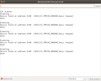

Hi guys, is there anyone that have used the bno080 on the teensy 4.0 and the bno080 is not even detected by the i2c scanner ?
I have two bno080 and feels like they are both frozen in some sort of undetected status.
Thanks
Thanks
Short answer is yes. Several of us have tested the BNO080 in I2C mode. There was an issue but as Paul mentioned in post #71 that has been fixed since Teensyduino 1.49. We are up to 1.53 (latest). With out further information its hard to speculate, like whats your hook-up, what breakout board are you you using, etc. First I would check the wiring and run the scanner that is under examples in Wire.
I have a BNO080 sitting right here. I ran File > Examples > Wire > Scanner on a Teensy 4.0 just now. Here's the result.
The Scanner example definitely does find it. BNO080 definitely does work with Teensy 4.0.
If you're getting nothing detected by the scanner, something is probably wrong with your hardware. We can help you try to find & fix the problem, but if unless you show us photos that help is only going to be blind guessing.
