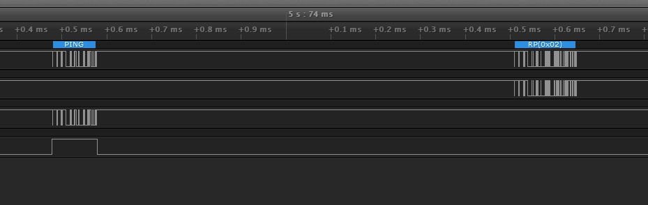

Right now playing with Dynamixel servos. hooked up to Serial1 through a Robotis Open RS485 expansion board (also does TTL). It has the hardware setup for
TX, RX, Direction pin, plus +3.3v and 5v...
Did some initial editing of my BioloidSerial library to work with it, currently only with Direction pin, will try later with setting Serial port into half duplex mode...
Part of it appears to be working but my library is not picking up the responses... Need to debug, to see where the issue might be...
Looks like the data should be there. Looking at LA output.
Top line is the DXL buss that the servos see and respond. Line 2 is pin 0 which should be the RX pin, I receive the data back on. Line 3 is TX pin, where the commands go out and Line 4 is the direction pin output which is driven by Serial1...
Again maybe just problem with my library... First off see if I am receiving anything... Note: I hacked up my test app, to use Serial2 for the Serial inputs and outputs instead of Serial so I could use commands... And that appears to be working fine.
EDIT: Timeout issue in the library. When the library was originally written it was for AVR 8 bit boards running at 16mhz and timeouts were done by timeout loops.
When I added support for t3.x I just changed the timeout value... But that was not caught in the #ifdef for t3.x and even if it did, would not be high enough...
Probably time to break down and use a timeout using something like an elpasedmillis...
