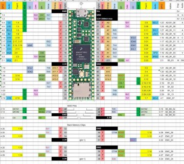

Is the schematic available yet? It's the easiest way for me to map the pins for CircuitPython. Thanks!
Oh sweet Jesus I can finally order one! Sorry I haven't read through the thread in it's entirety but which audio shield is appropriate for the 4.1?
Nope, sorry. I hope to get to the schematic in a few days.
Here's a set of defines that might help.
// mux config registers control which peripheral uses the pin
#define CORE_PIN0_CONFIG        IOMUXC_SW_MUX_CTL_PAD_GPIO_AD_B0_03
#define CORE_PIN1_CONFIG        IOMUXC_SW_MUX_CTL_PAD_GPIO_AD_B0_02
#define CORE_PIN2_CONFIG        IOMUXC_SW_MUX_CTL_PAD_GPIO_EMC_04
#define CORE_PIN3_CONFIG        IOMUXC_SW_MUX_CTL_PAD_GPIO_EMC_05
#define CORE_PIN4_CONFIG        IOMUXC_SW_MUX_CTL_PAD_GPIO_EMC_06
#define CORE_PIN5_CONFIG        IOMUXC_SW_MUX_CTL_PAD_GPIO_EMC_08
#define CORE_PIN6_CONFIG        IOMUXC_SW_MUX_CTL_PAD_GPIO_B0_10
#define CORE_PIN7_CONFIG        IOMUXC_SW_MUX_CTL_PAD_GPIO_B1_01
#define CORE_PIN8_CONFIG        IOMUXC_SW_MUX_CTL_PAD_GPIO_B1_00
#define CORE_PIN9_CONFIG        IOMUXC_SW_MUX_CTL_PAD_GPIO_B0_11
#define CORE_PIN10_CONFIG       IOMUXC_SW_MUX_CTL_PAD_GPIO_B0_00
#define CORE_PIN11_CONFIG       IOMUXC_SW_MUX_CTL_PAD_GPIO_B0_02
#define CORE_PIN12_CONFIG       IOMUXC_SW_MUX_CTL_PAD_GPIO_B0_01
#define CORE_PIN13_CONFIG       IOMUXC_SW_MUX_CTL_PAD_GPIO_B0_03
#define CORE_PIN14_CONFIG       IOMUXC_SW_MUX_CTL_PAD_GPIO_AD_B1_02
#define CORE_PIN15_CONFIG       IOMUXC_SW_MUX_CTL_PAD_GPIO_AD_B1_03
#define CORE_PIN16_CONFIG       IOMUXC_SW_MUX_CTL_PAD_GPIO_AD_B1_07
#define CORE_PIN17_CONFIG       IOMUXC_SW_MUX_CTL_PAD_GPIO_AD_B1_06
#define CORE_PIN18_CONFIG       IOMUXC_SW_MUX_CTL_PAD_GPIO_AD_B1_01
#define CORE_PIN19_CONFIG       IOMUXC_SW_MUX_CTL_PAD_GPIO_AD_B1_00
#define CORE_PIN20_CONFIG       IOMUXC_SW_MUX_CTL_PAD_GPIO_AD_B1_10
#define CORE_PIN21_CONFIG       IOMUXC_SW_MUX_CTL_PAD_GPIO_AD_B1_11
#define CORE_PIN22_CONFIG       IOMUXC_SW_MUX_CTL_PAD_GPIO_AD_B1_08
#define CORE_PIN23_CONFIG       IOMUXC_SW_MUX_CTL_PAD_GPIO_AD_B1_09
#define CORE_PIN24_CONFIG       IOMUXC_SW_MUX_CTL_PAD_GPIO_AD_B0_12
#define CORE_PIN25_CONFIG       IOMUXC_SW_MUX_CTL_PAD_GPIO_AD_B0_13
#define CORE_PIN26_CONFIG       IOMUXC_SW_MUX_CTL_PAD_GPIO_AD_B1_14
#define CORE_PIN27_CONFIG       IOMUXC_SW_MUX_CTL_PAD_GPIO_AD_B1_15
#define CORE_PIN28_CONFIG       IOMUXC_SW_MUX_CTL_PAD_GPIO_EMC_32
#define CORE_PIN29_CONFIG       IOMUXC_SW_MUX_CTL_PAD_GPIO_EMC_31
#define CORE_PIN30_CONFIG       IOMUXC_SW_MUX_CTL_PAD_GPIO_EMC_37
#define CORE_PIN31_CONFIG       IOMUXC_SW_MUX_CTL_PAD_GPIO_EMC_36
#define CORE_PIN32_CONFIG       IOMUXC_SW_MUX_CTL_PAD_GPIO_B0_12
#define CORE_PIN33_CONFIG       IOMUXC_SW_MUX_CTL_PAD_GPIO_EMC_07
#define CORE_PIN34_CONFIG       IOMUXC_SW_MUX_CTL_PAD_GPIO_B1_13
#define CORE_PIN35_CONFIG       IOMUXC_SW_MUX_CTL_PAD_GPIO_B1_12
#define CORE_PIN36_CONFIG       IOMUXC_SW_MUX_CTL_PAD_GPIO_B1_02
#define CORE_PIN37_CONFIG       IOMUXC_SW_MUX_CTL_PAD_GPIO_B1_03
#define CORE_PIN38_CONFIG       IOMUXC_SW_MUX_CTL_PAD_GPIO_AD_B1_12
#define CORE_PIN39_CONFIG       IOMUXC_SW_MUX_CTL_PAD_GPIO_AD_B1_13
#define CORE_PIN40_CONFIG       IOMUXC_SW_MUX_CTL_PAD_GPIO_AD_B1_04
#define CORE_PIN41_CONFIG       IOMUXC_SW_MUX_CTL_PAD_GPIO_AD_B1_05
#define CORE_PIN42_CONFIG       IOMUXC_SW_MUX_CTL_PAD_GPIO_SD_B0_03
#define CORE_PIN43_CONFIG       IOMUXC_SW_MUX_CTL_PAD_GPIO_SD_B0_02
#define CORE_PIN44_CONFIG       IOMUXC_SW_MUX_CTL_PAD_GPIO_SD_B0_01
#define CORE_PIN45_CONFIG       IOMUXC_SW_MUX_CTL_PAD_GPIO_SD_B0_00
#define CORE_PIN46_CONFIG       IOMUXC_SW_MUX_CTL_PAD_GPIO_SD_B0_05
#define CORE_PIN47_CONFIG       IOMUXC_SW_MUX_CTL_PAD_GPIO_SD_B0_04
#define CORE_PIN48_CONFIG       IOMUXC_SW_MUX_CTL_PAD_GPIO_EMC_24
#define CORE_PIN49_CONFIG       IOMUXC_SW_MUX_CTL_PAD_GPIO_EMC_27
#define CORE_PIN50_CONFIG       IOMUXC_SW_MUX_CTL_PAD_GPIO_EMC_28
#define CORE_PIN51_CONFIG       IOMUXC_SW_MUX_CTL_PAD_GPIO_EMC_22
#define CORE_PIN52_CONFIG       IOMUXC_SW_MUX_CTL_PAD_GPIO_EMC_26
#define CORE_PIN53_CONFIG       IOMUXC_SW_MUX_CTL_PAD_GPIO_EMC_25
#define CORE_PIN54_CONFIG       IOMUXC_SW_MUX_CTL_PAD_GPIO_EMC_29
