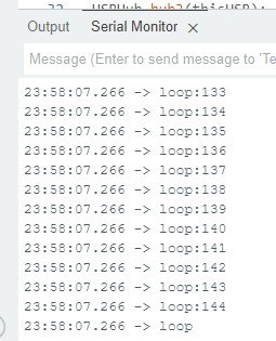

  • prova_usbHost.ino

Thanks Paul, you are right and I noticed it after posting but the problem persists even after deleting the double statement

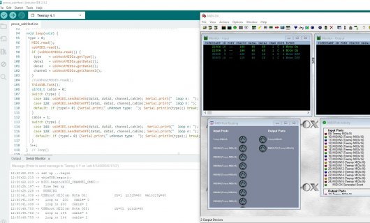

I did a new test with interesting results:
I connected the HUB to the PC and the Teensy USB to the HUB
I connected the keyboard directly to the Teensy USBHOST
I used MIDIOX to receive notes on and off which I had sent from Teensy loop using data received from the keyboard
USB type = Serial + MIDIx16 always used
>>> Everything works normally <<<
I send same msg received from Keyboard to CABLE 0 and CABLE 1 and I see them on MIDIOX (see attachment)
So I think the problem should be investigated in the usbHost_36 library that have problems when manage an HUB for MIDI msg. May be midi protocol require several classes... ? Unfortunately I don't known midi protocol over usb.
Many thanks for your support.

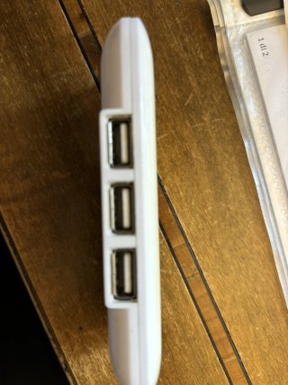

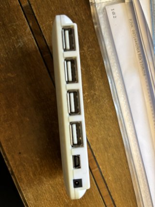

I connected a USB MIDI device through a USB hub to Teensy 4.1. Here is a photo of the hardware on my desk, so you can see the hardware I used for testing.
I pressed the drum pad buttons many times. It always prints the note on/off messages. I was not able to reproduce any problem where the program froze or stopped responding.

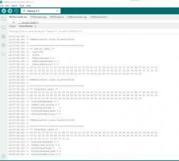

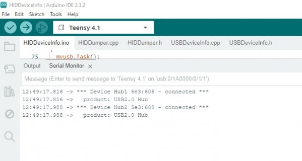

I add additional info coming from USBHost_viewer.ino in 3 situations:
1) when I plug in the viscount keyboard directly to usbHost
2) when I plug in a 2.0 HUB alone
3) when I plug in viscount keyboard to Hub
  • 3 plugin Keyboard to HUB HIDDinfo.txt

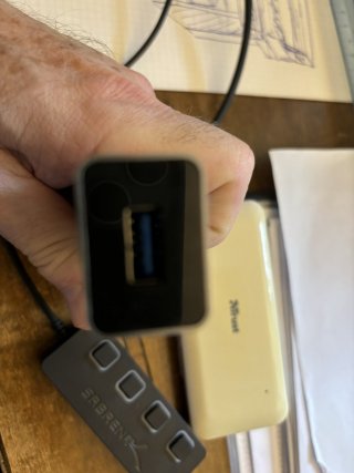

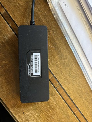

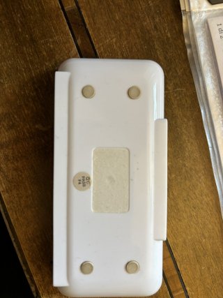

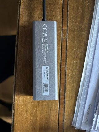

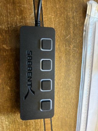

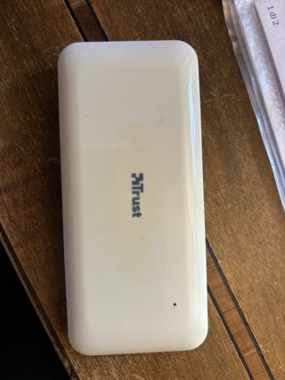

@Paolo157: As an additional test point, I connected my SABRENT 4-port USB 3.0 Hub (HB-UMP3) to the USBhost port on my T4.1, with my MIDIplus AKM322 mini USB MIDI keyboard connected thru the hub. As Paul reported (and I am likewise running your sketch with his modifications included), my setup also continued to report loop numbers without interruption, as well as reporting noteOn & noteOff messages in the Serial Monitor as I operated keys on the keyboard. At this point, I would lean towards suspecting your USB hubs (can it be true that you have two different USB hubs, BOTH of which cause a similar hang-up ??). Any chance that you could try a different USB hub, maybe even the same SABRENT model that I used, as that is known to have worked ??

Thanks Mark,
I bought a new SABRENT 4 ports USB 2.0 HUB like yours (can see in the picture attached), because I had same doubt of you after having seen the tools used by Paul.
I'm testing now and it is working but some problems persist !
TEST DONE:
test 1) power off - plugin HUB to usbHOST - power on : GOOD loop number appear
test 2) power off - all portSwitch off - plugin keyboard to Hub port 1 - power on: GOOD notes on /off received when portSwitch on
test 3) power off - all portSwitch off - plugin keyboard to Hub port 2 - power on: GOOD notes on /off received when portSwitch on
test 4) power off - all portSwitch off - plugin keyboard to Hub port 3 - power on: GOOD notes on /off received when portSwitch on
test 5) power off - port 1 Switch ON - plugin keyboard to Hub port 3 - power on : GOOD notes on /off received
test 6) equal test 5) but port 2: same results
test 7) equal test 5) but port 3: same results
Anomalous behaviours:
test 8) power off - all portSwitch off - plugin keyboard to Hub port 4 - power on: FAILED: Teensy runs loops but stops as soon as I push the port 4 switch ON.
test 9) power off - port 4 Switch ON - plugin keyboard to Hub port 4 - power on: FAILED: Teensy stops before loop: none loop numbers appear
test 10) equal test 5) but port 4: FAILED: Teensy stops before loop: loops number do not appear.
test 11) hot plug in / out stops the Teesny or inhibits Teensy to receive messages from any ports
COMPLESX test 12) :
  • power off - all portSwitch off - plugin keyboard to Hub port 1 - power on switch port1 ON: GOOD switch port1 Off ;
  • THEN plug in keyboard from port 1 to port 2 : GOOD even with switch port 2 off ;
  • THEN plugin keyboard from port 2 to port 3 : GOOD even if switch port 3 is off;
  • THEN plug in keyboard from port 3 to port 4 : FAILED Teensy do not receive message and after none of the ports is able to receive message even if loop runs.
Conclusions:
  • HOT plug in / out generate potential random behaviour even on other ports;
  • seems Teensy not able to manage port 4

I've ordered the Sabrent HB-UMP3 hub.
The hub I used for testing (see photo in msg #9) was Sabrent HB-UMLS. From the top side it looks very similar to HB-UMP3. The part number is printed on the bottom side.
@Paolo157 - Could you please check the actual part number on the hub you used (photo on msg #17). Or if the problem was with another hub, can you give me a photo and part number, so I can try to buy that hub for testing. To have any hope of getting to the bottom of this problem, I need to be able to reproduce it, which means finding that specific hub for testing.
Thank you Paul
I have tested 3 hubs 2.0 in this order:
  • a very old NTrust with 8 usb A an usb micro and power jack
  • a Graugear with 4 usb no power
  • a Sabrent with 4 usb
attached image of all hubs but unfortunately le older one has lost the label with model and s/n
Thanks in advance.
Let me tell you that I 'll be unable to make same test as in the past because I'm changing the keyboard (piano). The new one will be probably arrive in one or two weeks.
Thanks
Paolo

This hub info is good. But I also need you to tell me clearly which of these 3 hubs had the problem and which were trouble free?
Can you also give me photos or specific model number info for the keyboard you used?
Please understand I'm asking so many questions because I already made one unsuccessful attempt to reproduce the problem based on the info from msg #1 - #8. Since my results in msg #9, now I know I need ti unplug cables, which I didn't see in the first 8 messages. Maybe that was the only thing missing? But before I clear off my workbench (currently has some modular synth stuff in need of help) I want to get as many details as clearly as possible, so hopefully when I do set this up again I will be able to reproduce the problem.
