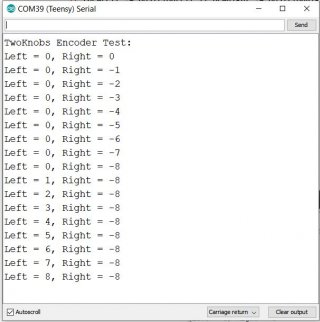

Using two KY-040 Rotary Encoder Module was tested:
with the following output on the serial monitor:

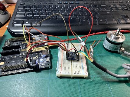

In addition a Rotary Encoder with Different Resolutions (200PPR, Line driver with 5V was used to test the index pin functionality:

Sorry for the delay. Never used one of those at 1/1000mm resolution before but it should work. Remember that the T4 is 3.3v not 5v. I used a level shifter for that. If you try it let us know if it works at that resolution.
Thanks, I will show the results
John
