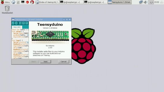

I'm making progress on the Linux ARM (Raspberry Pi) version. Got it fully running for the first time, just now.
Hope to have a final installer built later today.
I've updated the first post with the Linux ARM download.

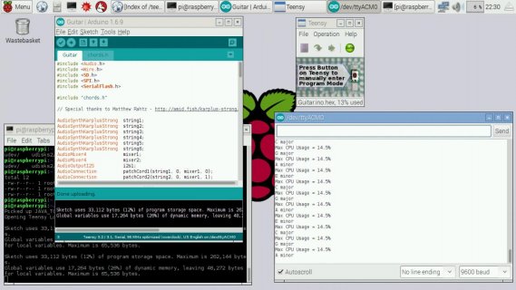

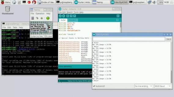

Here's a couple more screenshots with the Raspberry Pi background. :)

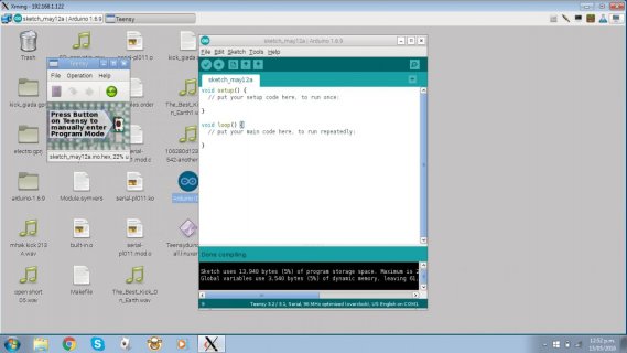

A while ago I set up 2 of my windows machines with xming, and with a bit of futzing around on the rpi (xprotocol stuff), I had the rpi desktop on my windows machines! A variation on the vnc theme in #16... So I have a couple of windows laptops I can walk around with wirelessly connected to the rpi desktop which is soon to have teensyduino etc and be tethered to (or not tethered to) a teensy!!
So the quick answer is, for usage case, ITS FUN TO HAVE LOTS OF COMPUTERS!!!
I can easily see a case of the teensy and the rpi exchanging meaningful data, and having the ability to programme both 'together' would be 'gold' (maybe??)
@PaulStoffregen ... thankyou for your work on arm. It all installed very nicely on my rpi 2 model B. So far so good. Here is a screenshot of teensyduino on the rpi running over X to my Xming install on a windows 7 machine. Cool!
edit: FYI the teensyduino installer file had permission set to 'executable by NO-ONE'
