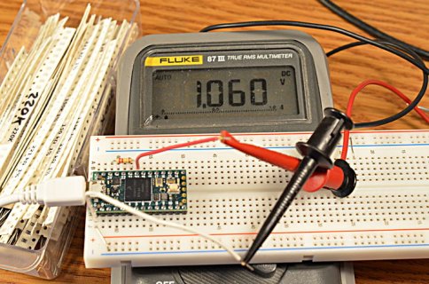

I read 100k on Page 956, Reference Manual - maybe that's not correct?
Looks like the reference manual is correct, the pulldown resistor is 100K.
To check this I connected 220K resistor between pin 20 and 3.3V and ran this program.
  pinMode(20, INPUT_PULLDOWN);
My multimeter reads 1.06 volts.

I got DMA working, though only a very simple test so far.
Just got up - cool you got it working going through the sketch started remembering what we did :) @KurtE did all the DMA stuff I played more with the chaining of the pins and XBAR setup, I think, seems like forever since we did that.
EDIT: Just to add for buffers. Kurt had this in is sketch that I believe is what you all are talking about for DMAMEM
const uint32_t buffer_size = 1600;
DMAMEM static volatile uint16_t __attribute__((aligned(32))) dma_adc_buff1[buffer_size];
DMAMEM static volatile uint16_t __attribute__((aligned(32))) dma_adc_buff2[buffer_size];
AnalogBufferDMA abdma1(dma_adc_buff1, buffer_size, dma_adc_buff2, buffer_size);
