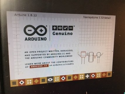

Installed TD 1.52 b3 on Win 10 latest with NO issues. Built and uploaded just two HEX files to work so far { for both T_4.x's }.
>> Only odd issue is that Teensy.exe takes about 15 seconds to start up. This is an updated WINDOWS issue {not new to TD 1.52} it seems as powering up Teensy.exe from TD 1.49 now acts the same. Problem is with first upload the IDE build aborts the upload waiting for it to respond.

Installed 1.52beta3 with Arduino IDE 1.8.12, on Windows 10 Pro 64 bit.
I'm having a problem building a low power test based upon Duff's Snooze library: the library included with TD 1.52b3 can not find "SnoozeTimer.h"
Target was Teensy 4.0.

In file included from D:\Arduino\hardware\teensy\avr\libraries\Snooze\src\hal\TEENSY_40\hal.c:5:0:
ResolveLibrary(SnoozeTimer.h)
  -> candidates: []
D:\Arduino\hardware\teensy\avr\libraries\Snooze\src\hal\TEENSY_40\hal.h:41:25: fatal error: SnoozeTimer.h: No such file or directory
Multiple libraries were found for "Snooze.h"
compilation terminated.
 Used: D:\Arduino\hardware\teensy\avr\libraries\Snooze
 Not used: L:\Progetti\Arduino\libraries\Snooze_OLD
Using library Snooze at version 6.3.4 in folder: D:\Arduino\hardware\teensy\avr\libraries\Snooze
Using library Time at version 1.6 in folder: D:\Arduino\hardware\teensy\avr\libraries\Time
The relevant part (includes and defines):
#include <Snooze.h>
#include <TimeLib.h>
volatile unsigned long int	g_elapsedMilliseconds;
volatile elapsedMillis g_millis;
volatile unsigned long int g_pulseCount1 = 0;
volatile unsigned long int g_pulseCount2 = 0;
// Snooze:
// Load drivers
// SnoozeTouch g_snoozeModule_touch;
SnoozeDigital g_snoozeModule_digitalPinInterrupt;
SnoozeTimer g_snoozeModule_timer;
// Install drivers to a Snooze Config Block
SnoozeBlock g_snoozeConfig(g_snoozeModule_timer, g_snoozeModule_digitalPinInterrupt);
Please let me know if I can be of further help.
