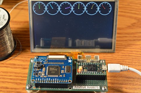

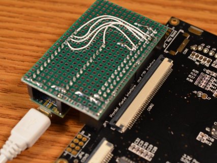

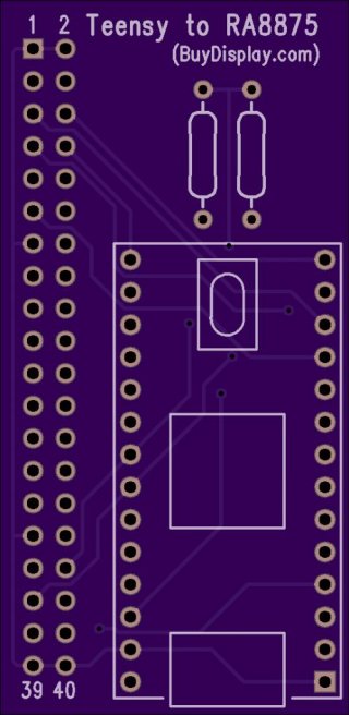

I made a little PCB to connect Teensy to these RA8875 displays from BuyDisplay.
