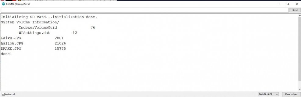

Serial Monitor fix double spaced lines copied to clipboard:
I retested this again on Windows 10 and I can't reproduce the problem.
Any chance there might have been an instance of teensy_ports.exe running while you installed? The installer is supposed to stop if Windows reports any error writing, so I can't understand how, but maybe teensy_ports.exe didn't get updated?

Update: If instead I choose the board under Serial ports and not under Teensy ports, than it Looks like I get single spacing...

I installed clean copy of Arduino-1.8.13 along with beta4. Can confirm what @KurtE posted on the SerMon issue with Win10x64
As long as you "choosing the board under Serial ports and not under Teensy ports, than it Looks like I get single spacing...". If you choose Serial under TeensyPorts you get the double space. Tested with Builtin_sdcard on a T4.1

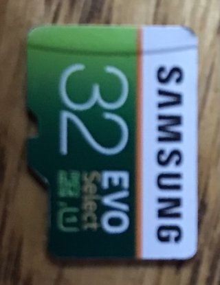

Just thought I would mention I again tried the SD Card list program (listfiles) External SPI reader works on both T3.2 and T4 (Sparkfun unit...)
Neither one will read the Samsung 32 EVO disk... Fails to initialize.
BUT if I build T4 with BUILTIN_SDCARD - it works with the EVO card...

Quick update here. I have been outputting some debug information in the code and output:
Initializing SD card...CardBegin Error: 12
SDFAT Cardbegin failed
initialization failed!
done!
Press any key to rerun
I believe that error code is:0X12,SD_CARD_ERROR_CMD58 - Read OCR register

The card that was giving me occasional startup trouble was also a Samsung "EVO Select U1". It was 128GB. I sent a package to Bill Greiman with hardware for testing and I included that troublesome card, so it's no longer here.
I just looked through my collection of cards. The Samsung ones I have are "EVO Plus U1" or "EVO Select U3". I currently don't have any "EVO Select U1" cards. Will get 2 of those from Amazon soon.
Info I can find online suggests U1 means 10 Mbyte/sec and U3 means 30 Mbyte/sec. I have no idea what the difference between Plus vs Select is, other than the color. But I did find at least some conversation claiming there is a substantial difference between "EVO+" and "EVO Plus".
Looks like mb-me32g on the back of the card.
As for the real differences the one that I don't have says(about twice as expensive): Up to 80MB/s transfer speed
The one I have says: Ultra-fast read write speeds: Up to 95MB/S Read and 20MB/S Write Speeds;
