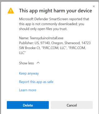

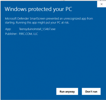

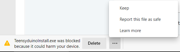

This new up to date Win 10 Pro machine gave this clicking the '...':
Keep ... Then it gave this after clicking the '^' option carat:
Keep Anyway ... Then this usual prompt because I had not done 'Properties Unblock' for the file and 'more info':
Run Anyway ... Installed and completed fine.

@Paul - for reference on this new Win 10 machine that doesn't like the NEW 2021 certificate I just downloaded this file with NO WARNING from browser or the system or BLOCKING - even the EXE runs without 'UNBLOCK' with the old and now expired 5 year old Certificate - just the UAE confirmation before starting :: pjrc.com/teensy/td_153/TeensyduinoInstall.exe

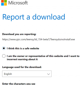

@Paul
Just downloaded Beta7 and pretty much saw what @defragster saw in post #4. I did one additional step. Before telling defender to Keep file I clicked on REPORT THIS FILE AS SAFE:
Once you click on report file you get presented with a simple edge form to fill out:
I filled it out and submitted. Everyone should probably do that to let MS know its safe. Did notice that it has the option for the owner of the site - think @defragster mentioned this before that maybe you want to fill out.

I also reported the download site as safe again in the process. There was a pre release test version I did that on as well the other day - and did that again this time when I tested to see if that version might be accepted - but it was treated the same.
The test safe 'I think this is a safe website' - so that suggests it isn't verifying the certificate or the exe but the source site. Which is odd given the noted TD 1.53 from the same server but different folder still works - as have all the prior downloads from that site that used the prior certificate.

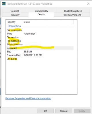

Seems like the certificate - which has valid looking entries (new dates and details) and notes somehow isn't passing their test? Maybe MSFT needs to pass out a secure database of valid certificates?
Note: I have gotten an Insider advance build of Windows on this machine the 21H1 build to be released sometime in first Half of 2021- but since you are seeing the same that shouldn't be an issue.
