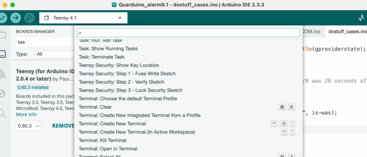

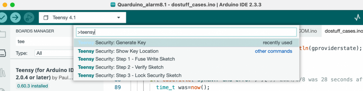

On M2 Macbook Air with Sonoma 14.6.1 and IDE 2.3.3
Tried all the shenanigans in earlier in post for win and mac but still get no security stuff:
Read security was not recommend from M2 mac but it should be possible? Oh and added: Should Teensy Loader show 1.60-beta3 vs 0.60?
Just reporting noticed today that issue at #27 seems to have resolved itself with no input from me except possibly upgrading to Sonoma 14.7.1
I'll be updating to Sequoia 15.1 soon and will report.

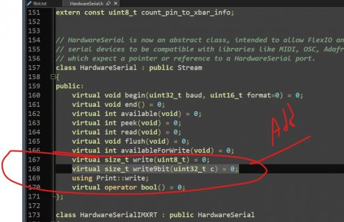

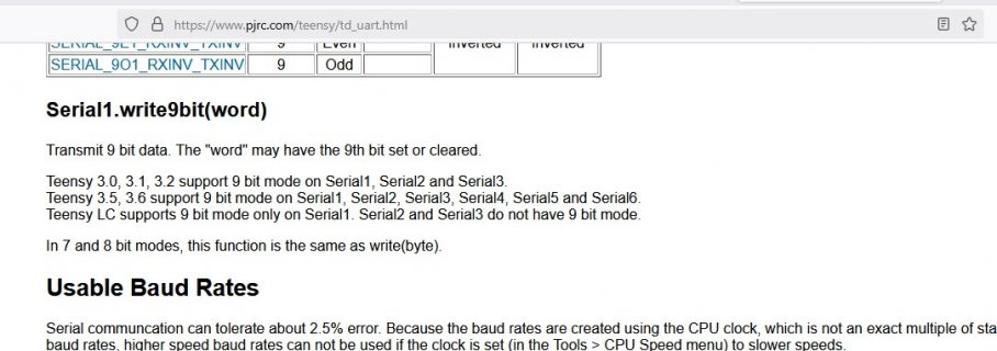

New HardwareSerial base class problem HardwareSerial *, p->write9bit fails to build for Teensy 4 & 3
#ifndef SERIAL_9BIT_SUPPORT
#error "define SERIAL_9BIT_SUPPORT in HardwareSerial.h"
HardwareSerial *p = &Serial1;
  p->begin(9600, SERIAL_9O1);
  p->write9bit(0x101);
Builds ok with 1.58.2. Fails to build with 1.59.0 Arduino\9bit\9bit.ino:10:6: error: 'class HardwareSerial' has no member named 'write9bit'
Please fix & test (looks to be just a line to add concerning the build failure). Thanks.
