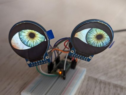

As some/many of you know, I have this thing for the Adafruit uncanny eyes project, tracking it from using it on a Teensy 3.2, 3.5, 3.6, Teensy 4.0, and Teensy 4.1. In the 3.x era, I used the 128x128 TFT and OLED displays (both from Adafruit and elsewhere). With the Teensy 4.0 and 4.1, I now use the 240x240 IPS displays, both from Adafruit and elsewhere.
Recently there was discussion about the round eye displays, and needless to say, I needed to get some. KurtE and mjs513 (maybe defragster also) have modified the ILI9341_t3 (and ST7789_t3/ST7789_t3n) library to work with the waveshare round eye displays. So naturally I needed to update my set of displays. I got it, and it works well (creepy of course, but that is the nature of the beast).

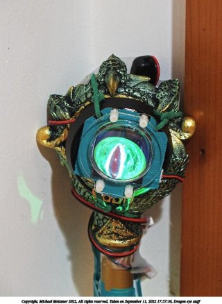

I'm in the middle of modding a staff from Spirit Halloween to have an interactive display. While at the moment, I'm using a Hallowing M4 for the project (due to the eye that I was using is not yet ported to Teensy), I would like to move it to the Teensy and the round eye display. I looked around ebay for suppliers to buy an additional round didplay. It looks like the stock of US suppliers is down from when I ordered in the past. But I discovered a Canadian supplier, which had a new variant of the display. So I ordered another 2 displays from them.
I decided I need to combine the pin-outs for the various SPI displays so that I could solder up a prototype board and easily move from display to display without having to dedicate a Teensy for each display (or change the pin connections). Unfortunately in moving the connections around, I mis-plugged one of the Adafruit 240x240 square displays, and wound up burning it out. So I went to Adafruit and ordered a replacement.
Finally after finalizing the sketch for the square display, I decided to do the round display next. In setting it up, I noticed I had cracked one of the displays, so I destroyed two displays in one day (or more likely, I had cracked the round display earlier, and I just noticed it today).
