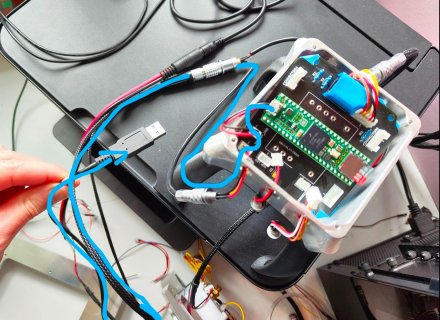

Just redo all the wiring and still not working ... the D+ and D- are connected to a PCB with a jst connector then it is out with a jst connector to lemo connector style in a cable and this cable then go to another lemo connector which is connected to the cable and USB connector. Do you think that the signal can be so attenuated that it will not deliver enough "signal" to the PC ? total lentgh is about 1.5m.
Of course I checked again with the multi meter and there a good continuity from Teensy to USB connector (about 0.6 ohm of resistance between 1st jst connector to USB connector pin).
Also, the last lemo connector (top left on the picture) has 5 pin : 3 are for the usb and 2x comes from a USB-C charger and deliver a 12v voltage to a pico PSU

Earlier I believed you had cut a USB cable and soldered its wires directly to the pads on the bottom side of Teensy 4.1. I assumed that from words "not from a USB cable connected to the D+ / D- and GND pins".
But in this photo, it is not a USB cable connected to D+, D-, GND pads. It looks at least 3 different wires, and short PCB traces with 4 inline connectors before connecting to a real USB cable. That might not be good enough for USB communication. USB is supposed to be shielded twisted pair with differential characteristic impedance of 90 ohms. If any of those wires and connectors you used don't have 90 ohms impedance, they will hurt the signal quality.
I'd recommend trying 2 things, for the sake of testing (even if not ok for final solution)
1: Disconnect those wires and solder the USB cable wires directly to the pads on Teensy 4.1
2: Edit usb.c to cause Teensy to use only 12 Mbit/sec USB speed. Look for the line with "force 12 Mbit/sec" comment. If you enable this line, Teensy will use 12 rather than 480 Mbit/sec speed when your program runs. If this wiring is marginal for USB, maybe 12 can work.
I did that and it works ! the communication was ok and I was able to flash the teensy correctly.
I did that (and fortunately you give me the trick to be sure that I was editing the right file ... because I was not at the first attempt) and now the USB is recognised correctly in Arduino IDE.
However, when I try to upload a sketch, it doesn't work : teensy red led is blinking slowly with low light (I think it means that it is waiting for USB).
That might confirm that the connectors from the teensy to the computer are altering the signal : do you think reducing the lentgh of the cable to a mximum can help ?

Try replacing all the wires carrying the USB signals with short lengths of real USB cable. Don't use ordinary hookup wire for D+ or D- anywhere, not even for short lengths. Even if all the wires are real USB cable, the use of non-USB connectors is still not good, but maybe you'll get lucky and have good enough signal quality if all the actual wire is the proper impedance.
On the USB cable pieces, connect the red, black and shield to GND. Don't leave any wire unconnected, because the characteristic impedance is designed for all the wires other than D+ and D- to be GND or power which is AC coupled to GND by capacitors. You'll get wrong impedance if any wire inside the cable is left floating.
Try to minimize the length of loose wire between the cable and connectors. Under 1cm is probably fine, so don't go too crazy worrying about 1mm difference. Also try to keep loose green and white wires the same length and close together. Just remember you're trying to keep as much of the signal path as possible at the proper 90 ohm differential impedance. Any extra wire length that isn't the inside of a proper USB cable is going to degrade your signal quality.
In my first prototype, I placed the Teensy USB connector close to the enclosure. I made a square opening on the enclosure, the size of a USB cable connector, which is then "closed" with a small aluminium plate and 2 screws. I removed the plate to insert the USB cable. I only used it for firmware update during prototyping, and finally never updated it during normal use.
