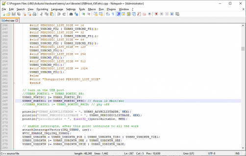

Remembering that it is possible to set the USB Device port [the micro-usb connector port] to 12Mbit full-speed instead of 480Mb high-speed, I skimmed through USBHost_t36.h, imxrt_usbhs.h and ehci.cpp to see whether that could be done for the host port as well.
Yes, it can, see ehci.cpp [to be found at C:\Program Files (x86)\Arduino\hardware\teensy\avr\libraries\USBHost_t36\ehci.cpp]:
When I uncommented line 267, compiled the code from message #13, uploaded it to the Teensy and powered the whole system down and up, I couldn't get the Arturia MIDI output to fail.
Did not test for an extended time though, so please give it a try with your setup as well.

Unfortunately forcing 12Mbit by uncommenting line 267 in ehci.cpp doesn't fix it for me, and I still get 'hanging notes'. In fact it's worse because adding the (unpowered) USB hub then doesn't resolve the issue anymore.
So for now, I'm still stuck with having to use a hub to make it work.

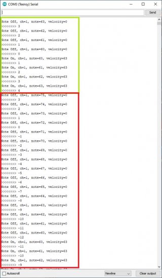

I had so I wrote a small program that kind of emulates the Arturia controller output using a Teensy 4.0.
Took me a few hours fiddling but finally got the error showing up: [GREEN is still OK, RED is where the erros start occuring.]
So it looks like a timing issue when (over)flooding the MIDI bus with data.
The emulation code spits out 16 notes ON, then 16 CC messages, then 16 notes OFF and then 16 CC messages.
This code only fails when both note_delay and CC_delay are 0 (zero). If either note_delay or CC_delay is 1 msec, then no errors occur:

  while (usbMIDI.read()) {                        // ignore incoming messages
I see you have been busy also in the meantime, so I will try your fix now and report back.

Really do not believe it will help with this problem. But if you have a little time to try replacing your ehci.cpp file, should be pretty easy to give it a try.
Found ehci.cpp here: C:\Users\Paul\AppData\Local\Arduino15\packages\teensy\hardware\avr\1.58.1\libraries\USBHost_t36 and replaced it by the one attached to your message in the other thread.
Restarted the Arduino IDE and compiled the host code from message #13.
Well, the errors are still there. The serial output looks very similar, if not identical, to the screenshot from my previous message.

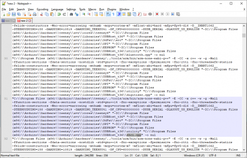

But later I checked the verbose compilation output and saw that ehci.cpp was used from another location:
So I replaced ehci.cpp in C:\Program Files (x86)\Arduino\hardware\teensy\avr\libraries\USBHost_t36 as well with your new version.
Again restarted the Arduino IDE and compiled the host code from message #13.
Unfortunately the errors are still there. So your guess is correct...

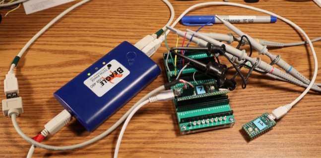

It's all wired up on my workbench. Hope to deep dive into the problem soon...
