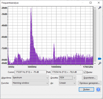

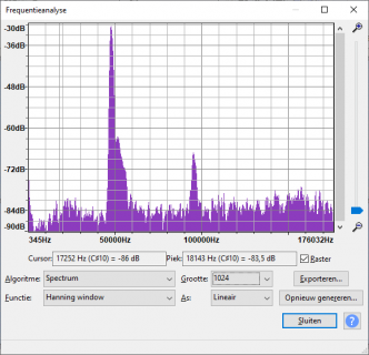

The next path was investigating how much we could gain by not using mic-in but using line-in instead, so I did some experiments.
I tied some tests with a tone ladder injecting signals on mic in and line in at 0, 10 and 20db
I did not really see any difference, just one important difference was noticed. When ik signal generator was disconnected the noise level dropped after a few miliseconds. Looking like some "mute" function on the line input.
After these tests I wanted to confirm what I found on a bat recording so I set op my dac and speaker and recorded using the SPU microphone and amplifier in the style I was used to. Amplification was set to 9db for both line-in and mic-in.

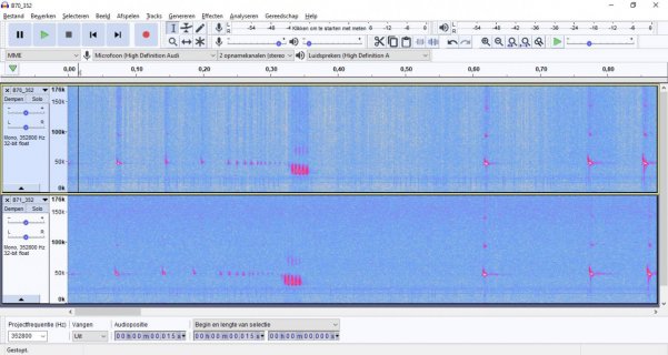

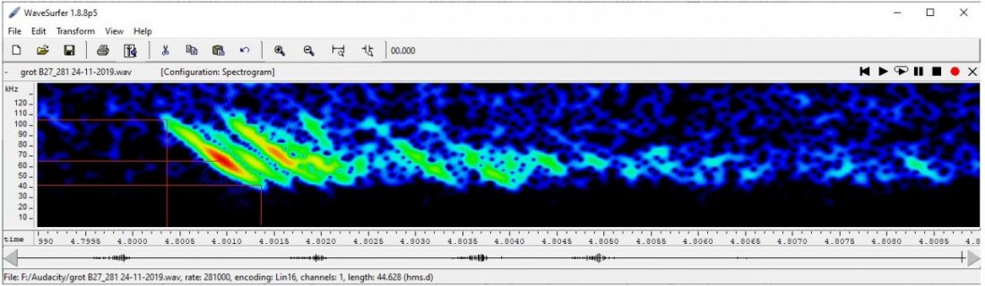

This is an image of two recordings, the upper is on the line in, the lower is mic in.
You can see lighter vertical lines at the moments where no sounds are registered, they are similar to the lower noise signal i did see after disconnecting the signal generator in earlier tests.

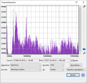

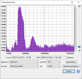

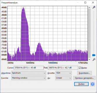

I took some spectrum images at different points. This one is the spectrum around the ping at about 0.07-0.08
Line in
Mic-in

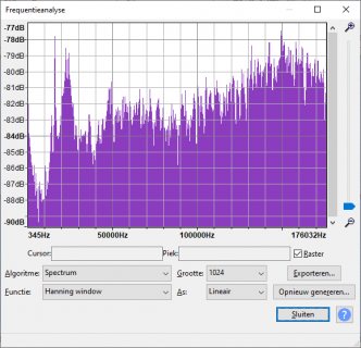

This piece is the silence between two "pings"at 0.08 - 0.18
Line-in
Mic-in
These are the short pings (feeding sounds) at 0.33-0.36
Line-in
Mic-in
Somehow the silences seem to be more silent but at the pionts where we are registering some sounds we can see almost no difference in the signals and the noise.
To me it seems the mic in will get us recordings just as good as the line input.

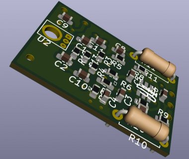

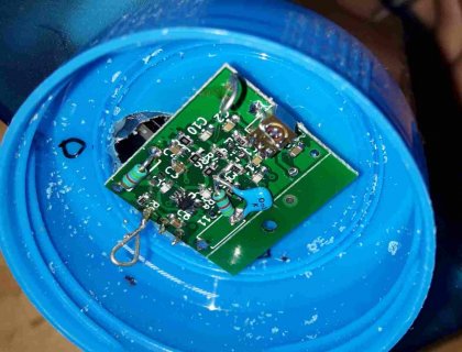

Mic Diff AOP amplifier PCB ICS40740 40730
After many weeks I try my small pcb with simple differential amplifier: Betters resuls for spurious at 27Khz.SMD small form-factor PCB: can be added to the input connectors.Design details*:
AOP: ADA4807: low cost,low noise,low power,available farnell RS and LTC simulation.
Gain: about 2 : can be adjust with 2 classical Resistor.
Some filtering : simple input HPass to reduce intelligible audio voice and other noise.
Low pass : mandatory for AOP stabilisation, simple first order.
Differential Impedance seen by mic can be adjusted (750 ohm for this test, very close to ICS 40730 specification )
I keep the modified single transistor input stage, at the output of this amplifier:I can compare many mic inputs by simple removing the front connector in live.
Corbee, PE1pwf, if you want one Pcb,ask me. I can also provide some SMD parts for you.
Design files : Be careful there is a mistake in my PCB, visible in schematic. See easy correction on PCB with through holes resistor. I remove the GBRfile from project
Next step : Define the optimal impedance and amplitude at the codec line input with correct #define value in code.
When this amplitude wil be well defined we can increase AOPdiff amplifier gain and remove first stage transistor amplifier.
I’will also be interested to try the new ICS40740 and look at this 27Khz spurious signal.

Remis, your boards look nice, I just wondered why you are using tru hole resistors for R10 and R11

I keep both SMD and trough hole resistor for gain adjustment You can choose. Throught hole technology is more easy to buy, found, and change. You can adjust the gain with same value for R10 and R11. With 5600 ohms the gain is ‘’low’’ and the output is connected to the transistor first stage input, without any saturation effect.

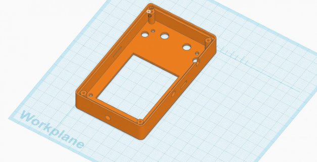

Regarding the case, has anyone already made a case with a 3D printer?

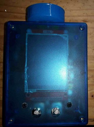

Hi Manu,
I can not see any bad English, just looks fine.
Where are you form?
The PCB and mic on ebay is the latest version, I do not know if anyone crated a 3d print file for a box. maybe someone did but I have not heared about it.
You probably cannot print for the price of the used enclosure but I have to agree cutting the hole takes some efforts.
I also had questions about complete kits, i am sorry there is not complete kit (yet) I might assemble partial kits.......
A complete build would probably cost near 100 euro's I do not want to be stocking a buch of 100 euro kits.
The teensy audio board has a connector for a headphone, if you want a speaker, you need some kind of amplified speaker.

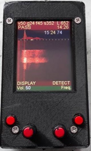

Yo can listen listen live in Time expansion mode but also heterodyne, auto-heterodyne and timedivision modes.
On youtube there are a few video's I made, not with the latest software but they give a good impression.
I am sure you will find it when searching for teensy bat detector

Just for fun I added an image of a recording I made. There are a lot of echo's behind this call.
It probably is some kind of Myotis with very wide band FM signal. It looks like a species I should not expect here.
Anyway, I think the frequency range it covers is very good. On my google drive you can see I also conducted some microphone tests. If looks like this is a fine set-up.

I created a 3D printed lid that replaces the lid from the 116x68x36mm Project Case as described by Edwin in his instructions when using his PCB. The 3D model can be found here: https://www.tinkercad.com/things/7gZ0wq9Fpcm
Here are some pictures:
I hope this is useful to someone. Note that the distortion on the edges of the lid was due to non-optimal printing conditions. This lid is designed to fit the bottom part of the 116 x 68 x 36mm black project box.
Adrian
