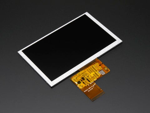

For sure camera: CSI and maybe one with FlexIO.
Display: Probably ILI9341/ILI9488 SPI.
Some Parallel Display: Which one? Wish the Buydisplay boards with the 40 pin connectors would have same Pin numbers for
ILI9488 as they do with RA8876 or RA8875). Which ones are people trying?
Looks like the ILI9488 supports either 8/9/16 bit Parallel? But looks like the RA887x are 16 bit?
Which displays are any of you using?

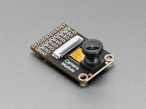

We also have some: 5MP cameras OV5640. Waveshare has some, plus Adafruit sells some. I have two different ones from Adafruit:
https://www.adafruit.com/product/5840 (which has Autofocus, which @mjs513 has example that sets it up)
Adafruit OV5640 Camera Breakout - 120 Degree Lens
Hobby-level microcontrollers are finally getting big and powerful enough to start handling camera modules that historically would have required a full computer or FPGA to handle. The RP2040 ...www.adafruit.com
One interesting capability of the last two, is they have the option to output JPEG format... Which so far I don't know any way to
use CSI to retrieve...
Thanks, I have a new RA8876 7" ordered... I see your read me with the pinoutRA8875 and RA8876 both support 8/16 bit parallel...
DEV board pinouts:
DEV Board ER-TFTM101-1 (40 PIN CONNECTOR)
Pin 14 -----------------> Pin 07 /CS
Pin 27 -----------------> Pin 11 /RST
Pin 17 -----------------> Pin 08 /RS (/DC)
Pin B0_00 -----------------> Pin 06 /WR
Pin B0_01 -----------------> Pin 05 /RD
Pin B0_04 -----------------> Pin 15 D0
Pin B0_05 -----------------> Pin 16 D1
Pin B0_06 -----------------> Pin 17 D2
Pin B0_07 -----------------> Pin 18 D3
Pin B0_08 -----------------> Pin 19 D4
Pin B0_09 -----------------> Pin 20 D5
Pin B0_10 -----------------> Pin 21 D6
Pin B0_11 -----------------> Pin 22 D7
For 16-Bit bus add
Pin B0_12 -----------------> Pin 23 D8
Pin B0_13 -----------------> Pin 24 D9
Pin B0_14 -----------------> Pin 25 D10
pin B0_15 -----------------> Pin 26 D11
Pin B1_00 -----------------> Pin 27 D12
Pin B1_01 -----------------> Pin 28 D13
Pin B1_02 -----------------> Pin 29 D14
Pin B1_03 -----------------> Pin 30 D15
