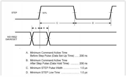

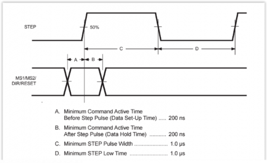

Stepper-motor-drivers have a STEP signal which is pulsed for each step, and a DIR (Direction) signal which controls the clock/counterclock direction of stepping.
Now all stepper-drivers require that a DIR signal is stable some 'setup' time before the stepper pulse, and remains stable some 'hold' time after the step pulse.
Further, they also have minimum timings for the step pulse signal.
See for example this page with an inventory of common used stepper/servo motor drivers and the timings they expect.
So per step , you actually need 3 events :
* setup DIRection - wait setup time
* set STEP pulse (high or active low, depending on driver) - wait max(step pulse time, DIR hold time)
* end STEP pulse
Example of these timings for the A3967-Driver :
We could pre-calculate the bit patterns needed on the output pins for these 3 events, in the step timer interrupt.
Then DMA could take care of outputting them with the right timing, with no further interrupts needed.
The alternative is an extra timer-interrupt, firing 3 times per step.

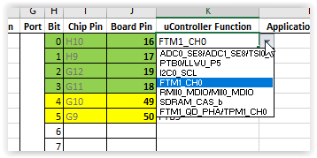

I've also created a spreadsheet that shows the alternate pin functions of a T3.5 (see attachment)
Thanks,
I merged our sheets together, this way you can for each GPIO (which is brought to a K64 pin) choose the function from the available functions on that pin.
It's done thru a simple data validation lookup in excel - your original sheet has been added to the workbook.
Updated sheet is available in the Github repo

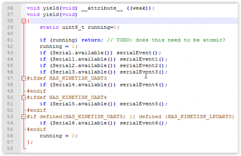

Here is the body of yield() :
Then I started commenting out parts of yield(), and here is what I found :
almost all of it can be commented out, except :
* if you build with 'USB Type : No USB', then line 44 - if (Serial1.available()) serialEvent1(); - can't be commented out or something blocks all execution. Program size is 2.448 bytes
* if you build with 'USB Type : Serial', then line 43 - if (Serial.available()) serialEvent(); - can't be commented out or something blocks all execution. Program size is 2.448 bytes
What works is :
* you build with 'USB Type : No USB', include line 44 - if (Serial1.available()) serialEvent1(); - Program size is 7.320 bytes
or
* you build with 'USB Type : Serial', include line 43 - if (Serial.available()) serialEvent(); - Program size is 6.392 bytes
Now the curious thing is that yield() is never reached, because I have an infinite loop inside loop().
But clearly the code inside yield makes the linker include some stuff which is needed to run.. It's about 4K of code.
Again, I don't care for the 4K extra code, but I'd like to fully understand what's going on.

Wonder if in the build the linker dropping 'unused' code? What happens with line 44 or 43 included in sketch setup() - or elsewhere as placeholders?

I've put this on my low priority issue list. It's entirely possible the linker is discarding the entire vector table when none if it seems to be actually used.
Realistically, this is going to end up together with the low priority issue of the hardware serial code always getting linked even when it's not used. Would be nice to solve someday... but such a disruptive change to code so widely used it going to take a lot of careful testing. Unlikely to happen anytime soon.
On the vector table, this might be as simple as adding an attribute. Maybe??
Hard to believe since a good part of mk20dx128.c is the vector table.
The problem appears to be in the link stage. The startup code (mk20dx128.c.o) is bundled into core.a along with the rest of the libraries. During the link process if there are no undefined symbols to the left of core.a on the command line satisfied by something within mk20dx128.c.o, then it will not be linked. There are several ways to fix this with the best being to keep this crucial file out of core.a and explicitly reference it on the command line. First.
This would seem to be a problem with VisualMicro emulation of IDE build. Under the IDE 1.8.1 I get the following results with no problem compiled on a T_3.6 at 180 MHz.
With NO USB the PJRC yield() brings in 10KB of code - but taking yield() out compiles and runs fine from the IDE and much smaller, qBlink and USB with void yield() is only 4KB::

// void yield():: Sketch uses 2440 bytes
// void yield() with qBlink & delayMicroseconds:: Sketch uses 3304 bytes
// compiled Smallest with LTO
// with PJRC yield() qBlink & delayMicroseconds:: Sketch uses 12928 bytes
// void yield():: Sketch uses 1132 bytes
// void yield() qBlink & delayMicroseconds:: Sketch uses 1804 bytes
// compiled Smallest with LTO :: USB Serial
// with PJRC yield() qBlink & delayMicroseconds:: Sketch uses 16040 bytes
// void yield() qBlink & delayMicroseconds:: Sketch uses 4412 bytes
  pinMode(LED_BUILTIN, OUTPUT);
#define qBlink() (digitalWrite(LED_BUILTIN, !digitalRead(LED_BUILTIN) ))
  qBlink();
  delayMicroseconds(100000);
void yield() {}
BTW - I think this is an issue FrankB noted - in creating this test with LTO I did run into this from the IDE (with or without USB Serial):
I:\arduino-1.8.1\hardware\teensy\avr\cores\teensy3/mk66fx1m0.ld:45 cannot move location counter backwards (from 00000408 to 00000400)
Error compiling for board Teensy 3.6.
  pinMode(LED_BUILTIN, OUTPUT); // removing this extraneous line (or haing qBlink in loop) removes the above ERROR
void yield() {}
In my experiments building with VisualMicro behaves the same as doing it from within Arduino IDE (I reinstalled VM, Arduino and TeensyDuino with recent versions to rule out anything there)
I have no T3.6 but I'll try to reproduce your results with a T3.5 tonight. (in my experiments I can reproduce the problem with both the MK64FX512 and the MK20DX256)
I see you use digitalWrite and other functions. This also includes a certain amount of code which may result in an executable which is large enough not to have this problem.
You could maybe repeat your test but only using direct register acces
I had no in-depth knowledge about how linking actually works, but as my intuition tells me there is something not 100% there, I am reading a few tutorials on it now, and trying to reverse engineer what exactly is happening. Here is a good tutorial I found : http://www.emprog.com/support/documentation/thunderbench-Linker-Script-guide.pdf
Thanks to all of you for looking into this. I think we are taking good steps forward towards using the Teensy 'bare-metal' from within Arduino/TeensyDuino.
