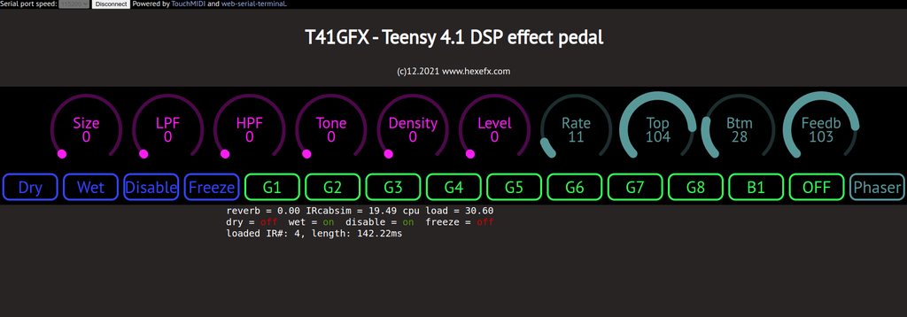

open the
PlateReverbStereo folder in PlatformIO and run upload (uncommenting the #define USE_TEENSY_AUDIO_BOARD line in main.cpp to make it work with the standard Teensy Audio Adaptor board) . All required libraries will be downloaded and installed.
Next, open the the
PlateReverb.html from the
Control_html folder in Chrome or Edge. Other browsers do not implement the WebMIDI and WebSerial required for the control interface.

One tip for creating nice sound scapes: start with silence, no input. Turn the FREEZE on and increase BleedIn to let a bit of signal pass into the infinite reverb tail. Hit a few notes, the sound will slowly build up into a rich harmony, or chaos
