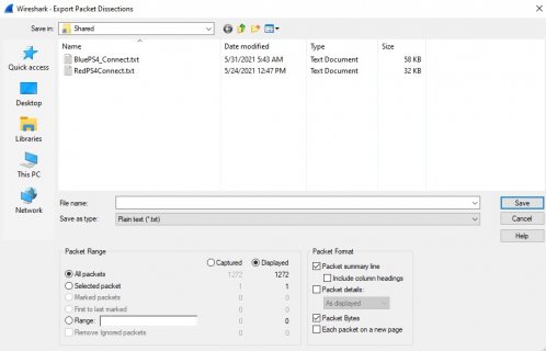

Morning @KurtE
Working with the Blue PS4 - the same one that you have. If that is any help.
Thanks, I will take a look again at that one soon.
Been sort of distracted today
Morning @KurtE
Been sort of distracted today![]()

Yeah that's pretty much what I was seeing when I attached it to my android phoneKurtE said:The Blue one I believe connected on Linux...
I think I posted this one earlier, but the edited WireShark capture from that:

22 9.420240 controller host HCI_EVT 7 Rcvd Command Status (Read Remote Supported Features)
0000 04 0f 04 00 01 1b 04 .......
23 9.475243 controller host HCI_EVT 6 Rcvd Max Slots Change
0000 04 1b 03 0c 00 05 ......
24 9.765301 controller host HCI_EVT 14 Rcvd Read Remote Supported Features
0000 04 0b 0b 00 0c 00 ff fe 8f fe d8 fd 7b 83 ............{.
25 9.765391 host controller HCI_CMD 7 Sent Read Remote Extended Features
0000 01 1c 04 03 0c 00 01 .......
26 9.766268 controller host HCI_EVT 7 Rcvd Command Status (Read Remote Extended Features)
0000 04 0f 04 00 01 1c 04 .......
