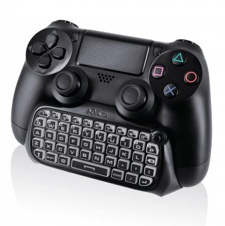

Evening all decided to get a new toy to play with via bluetooth: https://www.amazon.com/gp/product/B00UA55ZOG/ref=ppx_yo_dt_b_asin_title_o02_s00?ie=UTF8&psc=1. Basically its a key board that attaches to the DS4/PS4 but still need to connect to the teensy dongle.
Unfortunately think getting this working is wrapped up with getting a PS4 working with USBHost. It recognizes the keyboard - tries to connect and then crashes - crash report comes in handy for debugging:

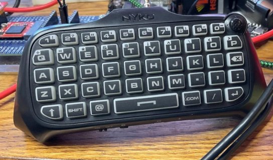

Ok, I broke down and ordered one :D Supposed to get here maybe Tuesday
@KurtE
Had a feeling you weren't going to not be able to resist the temptation and go down another rabbit hole :)
Was playing a bit this morning. Tried pairing USBHost2, said pairing was successful but little blue light didn't stay on and no keyboard data. Then out of curiosity I tried pairing with my iPhone and that worked but interesting thing ws the phone what me to type a 4 digit number on the keypad and hit return and then connect. Just playing for now. Have to get the dump from linux later. Doing this on and off - but have a feeling it may pair the same way as the PS4's that we are having a problem with.
Does that "Type Pad" work stand alone or, and/or in combo with : PlayStation DualShock 4 Controller.
Never picked up a PS4 controller as they were WIP ... is there one that is a good start?
Good afternoon Tim
That "TypePad" works alone even though it connects to the PS4. As for a good PS4 to start - You can try the Voyee (red) that Kurt mentioned earlier - he said he was able to get it to work. I have 3 of them and none will pair.
Good afternoon Tim
Hi Mike, seemed it was self powered and stand alone - just injects Audio to the controller ?

My NyKo keypad arrived today... I charged it a little, actually left it charging...
I loaded the example sketch KeyboardBT.
I built it first with: BluetoothController bluet(myusb, true, "0000"); // Version does pairing to device
Before the program started, I turned keypad on and pressed the BT button.
After it started up... Did not see many messages, but I then hit: 0000<cr>
Then I rebuilt the sketch without the pairing part
Then the program started up.... When I press the first key on the unit, it wakes up and connects and the sketch prints out the data like:
That looks promising! Similar function to the "Rii mini i8"?
Do you have a way to power that from a LiPo cell? Recent post #952, wondered if the Bt dongle running on less than 5V would function.
@KurtE - @defragster
Just tried it again. Seems a bit sensitive to pairing but once you get it, works like charm. Got it working with both a broadcom and a CSR4.0 dongle. So very promising for other projects :)
@defragster - there's a rechargeable battery in the keypad so it can work stand alone from the DS4 -only need to use the wire to charge it.
Very cool yours worked too. Just clicked order to arrive tomorrow.

I also have the NyKO, that attaches to a PS4 controller. Nothing that interesting with that one.
The most interesting one to talk about is the Rii one which also has a small touchpad...
