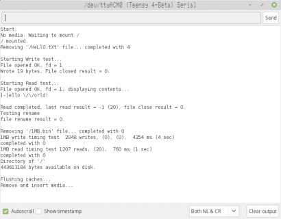

Since SD.h is working decided to hook up my EMIC2 text-2-speech board to the T4 and put a file on the sd card to be played by the EMIC2, figure good verification for both. Anyway, it worked, it found the card, the correct file and played it. I am attaching a recording from my phone (frankly its not a very good recording), need something to do better recordings, just for fun.View attachment Voice 001.zip
I have it hooked up to an amplified speaker so getting some static. I modified the library awhile ago to work with Teensies, don't even know if it would work on a avr board anymore :)

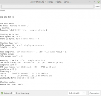

File size 5MB
Buffer size 100 bytes
Starting write test.  Please wait up to a minute
Write 257.67 KB/sec
Maximum latency: 149300 usec, Minimum Latency: 0 usec, Avg Latency: 387 usec
Starting read test.  Please wait up to a minute
Read 786.29 KB/sec
Maximum latency: 4090 usec, Minimum Latency: 0 usec, Avg Latency: 127 usec
- half speed of T3.6 ... oops.. ok, there is some potential to optimize it. it just uses the SPI-library functions.

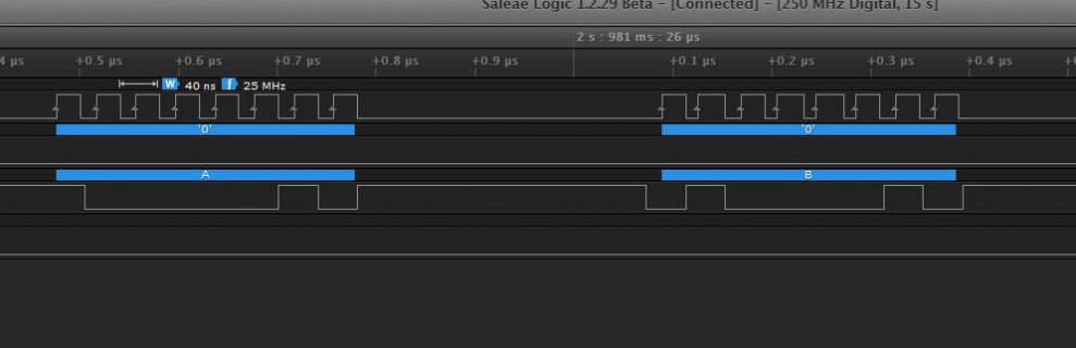

And for what it is worth... I have tried SPI at 30mhz... It appears like it is running at about 25...
Here is test run with 30mhz and LSBFIRST...
If I put 10Mhz into the above function it returns 06 vs the 08? d returns 8. Not sure why the d-2?
Yes, I provided setClockFreq snippet (post #454). If you look at the ref manual, the CCR DIV is treated as +2, so if DIV is 0, peripheral clock is divided by 2. If DIV is 1, clock is divided by 3 ... So if you want the clock divided by 8, you put 6 in the CCR DIV field.
The discrete SPI dividers for 75 mhz are 2,3,4,5 .... which gives SPI CLK of 37.5, 25, 18.75 ... the setClockFreq algorithm picks the divider less than or equal to user-requested frequency

Finally learning details about SPI that I never got into before. I had downloaded your changes in the Pull request awhile ago and changing the clock in SPIsettings is working perfectly. Put together a test sketch on using transactions (mirrors the one on teensy SPI page) and tested changing the clock against the various clock speeds (60mhz down to 500000hz).
at 40Mhz the clk pulses look more like sine waves with freq of about 38Mhz, MOSI looks pretty good, just getting spikes on the leading and trailing edges
at 30Mhz reading 25.5Mhz, clk beginning to look like nice squares waves, MOSI still good (yep same as you got)
at 10 MHz reading 9.43Mhz, guess would call it ringing in the square wave pulse for the clock, MOSI still good but still with the spikes
at 20 Mhz reading 18.86Mhz, clk getting better, looking like a nice square wave, MOSI still good with the spikes
at 4 Mhz reading 3.97 Mhz, clock nice square wave,  MOSI still good but still with the spikes
