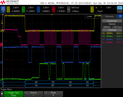

I put a very minimal SPI library in, and it's able to read the ID bytes from a serial flash chip with this code. Much work still needed to implement all the usual SPI library features!
#include "debug/printf.h"
  printf("begin\n");
  digitalWrite(9, HIGH);
  pinMode(9, OUTPUT);
  SPI.begin();
  SPI.beginTransaction(SPISettings(8000000, 0, 0));
  digitalWriteFast(9, LOW);
  SPI.transfer(0x9F);
  uint8_t b1 = SPI.transfer(0);
  uint8_t b2 = SPI.transfer(0);
  uint8_t b3 = SPI.transfer(0);
  digitalWriteFast(9, HIGH);
  SPI.endTransaction();
  printf("%02X,%02X,%02X\n", b1, b2, b3);
