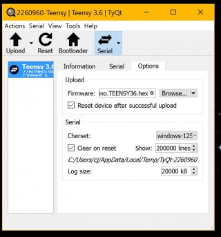

The serial setting in the IDE is ignored because it poses more problems than it solves. First, in non-Serial modes you could not select the board you want. This is especially bad if you happen to have another Serial device plugged in, because then it will probably be selected in the IDE even though you don't want to target it. I tried to ignore the selection when a non-Serial USB type is selected but then the behavior becomes even more confusing when you switch USB type. Also, this cannot deal with one sketch -> multiple boards upload.
Instead, TyQt associates one or more boards with a sketch binary file. You can see this by right clicking on a board, the "Drop association to '<sketch>.hex'" menu item. If you click on it this association is dropped, and the next upload will ask you where you want to send it.
You can associate a sketch with multiple boards. Three ways to do that:
  1. Select those boards when you get the selection prompt on upload. Drop the currently associated board(s) to get it on the next upload.
  2. Copy-paste the firmware path under the Options tab ("Firmware:") to all the boards you want to link to this firmware. Click Upload in the IDE.
  3. After associating your boards (as in 2), click Verify in the IDE and then click Upload on the board you want in TyQt. Note that you can select multiple boards in TyQt too, and then click Upload.

If you have used TyQt before 0.8.0 the multi-selection in 1 will not work if you have done the "Integrate to Arduino" before 0.8.0. You need to do a "Restore" and then "Integrate" cycle in the integration tool. And then restart the IDE.
Thanks guys!
Tried #1 and it works great. I almost did #3 yesterday, did no do the paste in... Instead I did option #4 which was to open 2nd instance of Arduino IDE to same program and then did upload, which associated it with 2nd board, then I had to do upload command in each of the Arduino IDEs to update both...
Thanks again - Nice program!

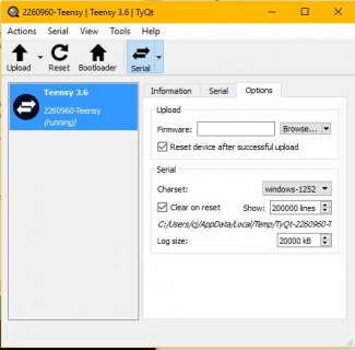

Been using TyQt GUI for a couple of months now, and it's becoming routine. But only the GUI and mainly for the ability to do soft resets, and the superior upload mechanism.
I haven't felt a need to try the command line version yet ... I'm not adverse to command line tools, but I'm wondering what the benefit is? Perhaps it's only for those working with multiple teensy's ?
A few minor issues with the GUI:
1) Serial gets randomly disabled. Seems to happen when I click into the TyQt GUI window from another window. Easy enough to Enable again, but what could be the cause?
2) I'm still hoping new release provides ability to set tab sizes, or at least match them with the Arduino IDE setting.
3) Doesn't handle high-dpi displays well (like 3000 x 2000 on my Surface Book). This snippet show some of the issues like: crowded lines of text on teensy symbol, can't read the whole pull down in charset menu options.
And tabs spacings are not same as my desktop with its 'typical' Dell 1920 x 1080 monitor:
(& its not solved by dragging the window wider)

Lastly, regarding links to TyTools, why both GitHub and BinTray? Not familiar with the latter but seems to be duplication?
@ninja2 - that vertical separator bar can drag right to show the 'Teensy Device' tab - or drag left to go away ( Ctrl+H )and hide.
