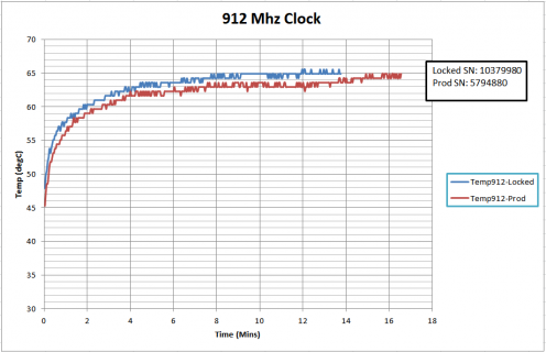

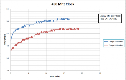

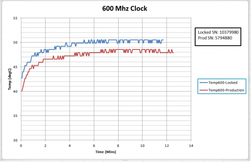

Got curious again about the temps while reading Tim's analysis so I redid the temps but for my loop temps I continuously calculated prime numbers between 2-100,000 and timed each Prime Number cycle with the associated temp:
  int lower = lower_init;
  time_now = millis();
  while ( lower < higher)
    flag = 0;
    for ( int x = 2; x <= lower/2; ++x)
      if ( lower % x == 0)
        flag = 1;
    //if ( flag == 0){
    //  Serial.printf("%d ", lower);
    ++lower;
  //Serial.println();
  Serial.print((millis()-time_now)*0.00001667,4);Serial.print(", ");
  Serial.println(tempmonGetTemp(),2);
The breakout board was my T4 breakout board and I used a Production T4 and the Locked T4 I have been experimenting with.
At 450Mhz about a 3.5deg diff where the Locked is running hotter than the Production T4. At 600Mhz I am only seeing about 2.5 deg difference between the 2 boards while at 912Mhz essentially no difference in temperatures. Since I like graphs (tells me more) I plotted both:
EDIT: Ref also early temp graphs with just temp in loop and 500ms delay. https://forum.pjrc.com/threads/67989-Teensyduino-1-55-Beta-1?p=286405&viewfull=1#post286405
Could you measuere at a lower frequency, too? ie. 450MHz
Hi Frank - just updated post #306 with the 450Mhz chart. The Locked teensy is running about 3-3.5 deg hotter than the Production board. Interesting correlation. The slower the speed the larger the delta between the 2 boards :)

Quite possible - the decryption is not clocked with cpu freq, but the flash bus freq (or similar), which is constant.
Morning all... Wondering are we talking about same hardware? Is one a REV B of the IMXRT and other a REV A? And if there is chance that might somehow change things?
Good point. All my T4's are Rev A's. Don't have any Rev B's

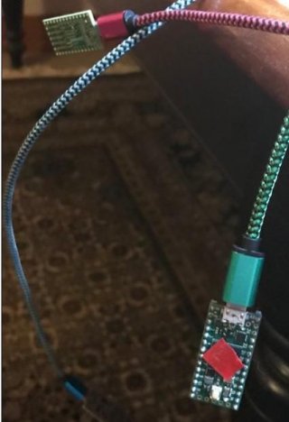

Note: Quick update... I am running @mjs513 on two T4s...
One is an older OshPark T4... The other is a new production T4. Both have no pins on them and are hanging off of my desk by USB cables. So air on all sides... Both started up pretty close to same time...
Note: the New one I have run the Fuse Write sketch on it... Which went part way through
... but won't load an .ehex currently.
Edit: been running maybe 10 minutes longer and one at about 49.8 and the other around 54.6
Note: I turned off the OSHPark one for about 10 seconds to confirm it is the one running cooler

Not sure yet about temp... As I mentioned in previous post, the new T4 running hotter than the older OSHPark T4... Also I have locked one running as well, although not a straight comparison as it has pins soldered in and piece of red tape...
And in the photo below the screens left to right: OSH, T4 prod, T4 locked:

Still not sure TEMP is an issue from Fuse change - the Product seems to have variability or change ... a few good Current samples would show if more power is used. It was odd back some posts where delay() increased the temp over just keeping busy in loop.
