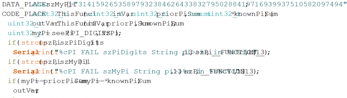

If my sketch crashes and I have
The crash report (as well as other stuff early on in next run) shows up in the Serial Monitor window when I use the (not in the build)Code:Serial.print(CrashReport);
USB type of MTP Disk Serial (Experimental)
But none of this output shows up with the MTP Disk(Experimental)
I do finally get some output after the sketch has completed setup:
Turned out I was going through NULL pointer...

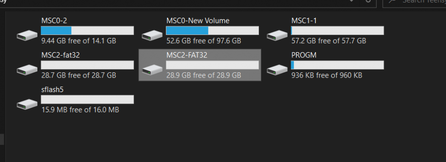

Setup for this is the starting of new round of: some MTP/MSC stuff that @mjs513 and I have started including adding file dates and times...
Easy setup- Note will be starting new thread on this as a follow up to my earlier TLA thread.
Current setup: Arduino 1.8,15 and this beta:
Update cores: with https://github.com/KurtE/cores/tree/FS_DATES (Added dates/times will have branch FS_Integration)
update MTP: https://github.com/KurtE/MTP_t4/tree/FS_Integration
update MSC: https://github.com/KurtE/UsbMscFat/tree/FS_Integration
Update LittleFS: https://github.com/Mjs513/LittleFS/tree/FS_Integration
Update: SD: (This is what I forgot) with https://github.com/KurtE/SD/tree/FS_Integration
run the sketch: https://github.com/KurtE/MTP_t4/blob/FS_Integration/examples/SD_MTP-logger/SD_MTP-logger.ino
And then on PC try to expand the Teensy/SD directory... And it called through null ptr to un updated SD Modify date and crashed...
