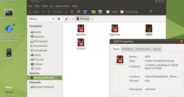

Good Morning all
Finally got the PI4 updated and operational last night or rather early this morning and started playing with IDE2.0. The PI4 is running Ubuntu-MATE-20.04 to start and the desktop is fairly windows like.
So ran my mtp-integrity-sketch to see how MTP was behaving on the PI4. Interesting how it shows it self in Ubuntu Mate.
first connects to the T4 disks faster than windows and shows as a device (phone) on the desktop.
when I open the device:
Did a right click on the QSPI disk and checked its properties and looks it gets the number of items on the disk right but free space shows as zero and the total bytes is strange
Now I guess I will see if I can get the too talking to each other
