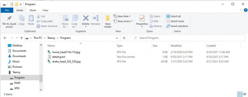

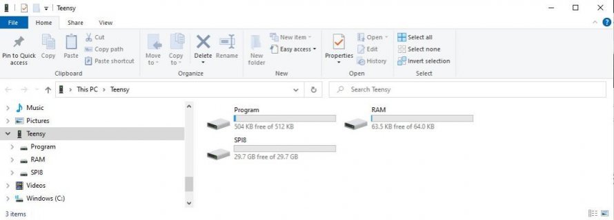

These are are all setup to with support for File object to support dates/times - API's/methods have not been approved so subject to change. But current stuff does show dates and time.
Update(9/21/2021) LittleFS has been updated to support creation and modification dates.
Example output from my Locked T4 on PC
