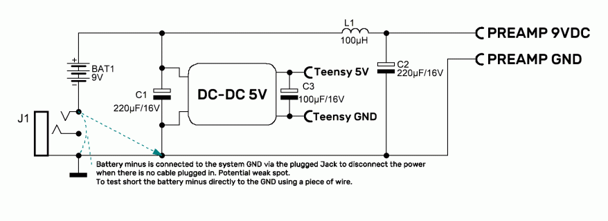

I'm trying to build a break music player with the teensy to fit inside of my guitar, I'm powering the Teensy off of the 9v battery in the guitar's preamp, going through a buck converter first before power goes to the Teensy. As soon as I start playing a .wav from the SD card, this noise begins. To be clear, at the beginning of the file when there is no song, but noise, the volume of the song is all the way down. Pushing a button fades the music up, but the noise can be heard even over the music.
When I disconnect the teensy from the 9v power supply, and power it with a usb cable from my laptop, there is no noise. So that indicates to me that it's a grounding issue with my circuitry, but I've been working on this device for weeks and I'm pretty confident I have it grounded properly.
Can anyone help point me in the right direction for troubleshooting?

Could the noise come from the buck converter? Have you tried a 5V powerbank for the Teensy just for comparison?
I don't have something like that on hand, though I might be able to rig something up with AAs.
If it were the buck converter though, wouldn't the noise be consistent? The noise is only present while the SD card is active...

Ground loops usually create a constant low frequency hum, not a high pitched clicks, which also are synced to the SD card reads. It sounds like a poor power decoupling. One potential weak point for the grounding might be the Jack Ring + battery minus connection used to power off the circuit when there is no cable plugged in. Temporarily connecting the battery minus directly to the GND will tell if this is the spot causing the issues.
A battery like the 9V block (alkaline?) has a higher output impedance than a power adapter output. With current draw spikes produced by the switching voltage regulator it will sag down a bit, repeating the current draw "waveform/noise" on the whole 9V bus, which is powering the preamp and polluting all the audio path.
On top of that, this is a 3A step down regulator. These controller chips usually have a low power mode (load under ~100mA or so), called pulse skipping mode. Could be that reading a file from an SD card + Teensy's normal power draw causes the switching controller to jump between the normal PWM and low power mode and this is creating the audible noise.
I'd try adding more decoupling capacitance, 100uF-470uF/16V right after the 9V battery and also 100uF on the 5V bus after the DC-DC converter. See if helps or at least has any impact on the noise sound. Capacitors should preferably be a low ESR ones. Good idea woild be to decouple the preamp with an LC filter. Something like this:

I tend to think it won't. It can be tested, though, assuming Teensy is powered from the 9V battery + DC-DC:
1. Unplug the piezo preamp output from the Teensy Line in. Connect the Teensy audio Line outputs to the amp/audio interface to hear the output,
2. Play something from the SD card
If the noise is present on the output it means the Teensy is producing it, piezo + preamp are disconnected.
If there is no noise without the piezo preamp plugged into the Teensy Line In, but it shows up as soon as you connect it, it means it comes from the piezo preamp. Most likely due to 9V rail being polluted with the switching noise.
