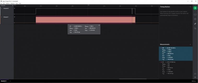

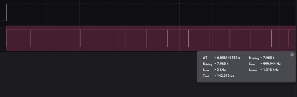

Today I also hacked up that function some more that printed that data, and used digital Write high/low with pin 0 for the whole duration and pin 1 around each call to the cached read...
And the capture of data also confirmed it:
Which shows the two getting free counts for the two FAT partitions.
A close up of the start of the first one shows that the majority of time it is waiting for the sectors to be read:
One of the interesting things with the new Logic 2 software, is you can use things like shift mouse select over a set of data and it will do things like count how many pulses happened in that region, which helps confirm some of the calculated data.
