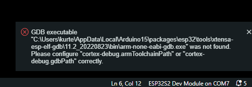

Like the ESP32-S2 board, failed to launch it.
Likewise I tried a Micromod ESP32 and it failed the same way.

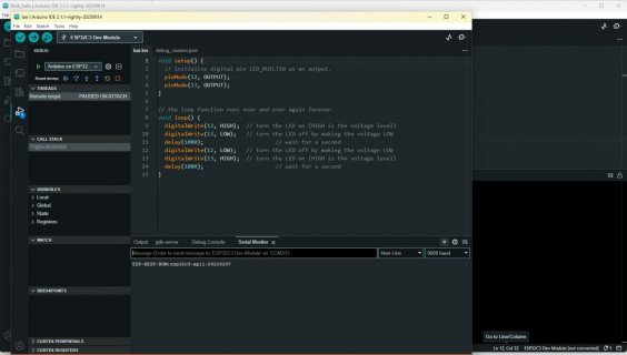

ESP32-C3 - was curious about these as they are a risc-v (not arm) board. The debugger actually comes up:
Not sure how well it works yet. Things like stepping on this board appears to fail. But I have an oddball clone of the ESP32-c3, I have a couple standard ones
waiting for me in my mailbox... Will hopefully try it out on those and see how it works.
