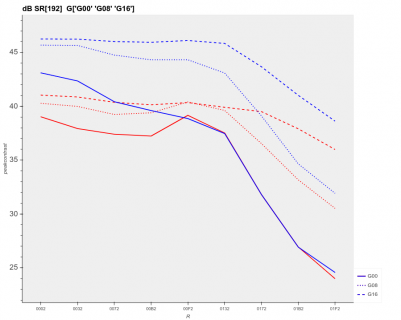

SGTL5000 tests part 6: REF_CTRL and harmonics
REF_CTRL, 1st/2nd HARMONIC
This is the final part of the analysis based on the files Edwin has collected for many different samplerates, gains and REF_CTRL settings. The graph below shows on the Y-axis
the value in dB (input was 0.05Vpp) for the signalpeak (green) and 1st (red) and 2nd(blue) harmonics for 3 samplerates (columns), 3 gains (0,8,16) and
all tested REF_CTRL settings. Each graph shows 3 groups of lines with equal-colours, the top-line in each group is associated with the highest gain.
REF_CTRL settings range from 0002 on the left to 01F2(SGTL5000 default) on the right. The Y-axis has been limited to -80 to -20 dB to make the graphs easier to compare.
The 2nd harmonic is for 192 and 281 always less strong than the 1st harmonic, this is however not as simple as it seems. The 2nd harmonic for a frequencysweep from 20-60 Khz covers a range from 60-180Khz. The maximum frequency that is (properly) recorded is around 0.42*SR for our setup(see earlier posts). The 192 samplerate reaches thus until 80Khz,
the 281 until 118Khz, and for 352 its 148Khz. From this it is clear that the estimates for the 2nd harmonic are based on a rather limited sample for the 192 and 281 samplerate.

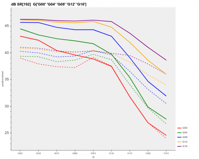

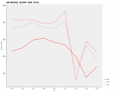

1st HARMONIC vs NOISE
For the 192 samplerate I also include a graph showing the "contrast" in dB between the peakvalue and the estimated noise ("silence"-section) in BLUE and between the peakvalue and the 1st harmonic in RED. The reason that I am showing this only for 192 is due to the fact that for the two other samplerates these graphs are unclear. What causes this is something I want to find out, it might be related to the problems I have stated before in estimating median noise. So for 281 and 352 I only include a graph where the contrast between peak and 1st harmonic is shown for the 3 gain levels as this estimate is only based on the part of the recording where a signal was present.
192
281
352
The graph for the 192 samplerate is thusfar the only situtation where it is very clear and based on multiple assesments that changing the REF_CTRL setting has a strong and consistent effect. Especially for a lower gain this effect is large (>20dB). When the gain increases these differences are diminished. Setting REF_CTRL lower or equal to 0132 is for this samplerate logical. For the other samplerates conclusions seem to be less clear, is samplerate 192 a "magic" setting producing less jitter in the system ??
EDIT: I have added an attachment for samplerate 192 where for a larger group of GAINS the contrasts for peak-noise and peak-1st_harmonic is show.

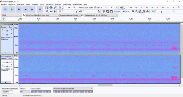

Well, here we are again finally a bit of hobby time.
Unfortunately it is wet and cold so no bats to play with and for testing we only have our digital pet-bat in a noisy in house environment.
I built the amplifier as described by aetertech. (Fortunately I had some bats around when I actually tested it)
It looks like a great amplifier, maybe the "best" one yet with lowest noise I ever buit.
However I was not so very pleased with the results. Every noise I made myself by walking or pushing a button or whatever sound was heard like a low frequency rumble, drum beats or other sounds like that.
Of course I also needed a high frequency sound to start the time expansion but I just love to have some kind of high pass filtering to keep the low frequencies out.
I could notice quite a bit less noise with the aetertech amplifier on the higher frequencies, in the end this could be expected.
Since the microphone I use has much more signal on 20Khz than 60Khz is made my amplifier so that gain was quite a bit more on 60kHz than 20Khz. So this could very well be the reason I see more more noise on higher frequencies using my old amplifier.
The gain on the aetertech amplifier was quite a bit higher than what I had constructed, especially near 20kHz, a recording of some social call near 20Khz already showed up with quite some harmonics in Audacity.
So I guess I have to admit I still do like the old amplifier.
Just for fun a few recordings, this one was outdoor recording bat and passing vehicle. Unfortunately the gain settings were not exactly matched.
I guess it is clear which one is the old amplifier and which one the aetertech circuit.
I don't quite understand where the vertical lines come from, they seem to rise out of the low frequency sounds but probably is some noise the passing vehicle makes.
This recording is not a real bat, I did try to match the gain settings for the bat sounds around 40Khz.
You can see the stronger signals on the aetertech amplifier on the lower frequencies.

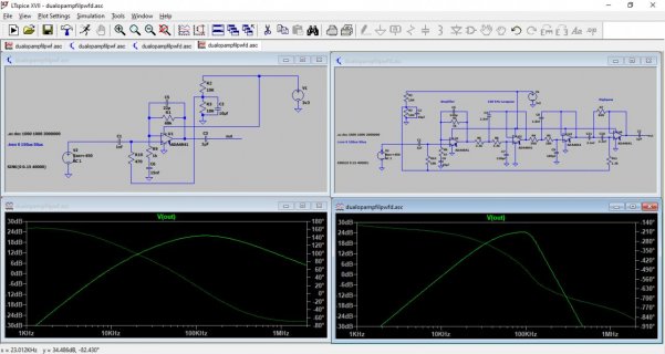

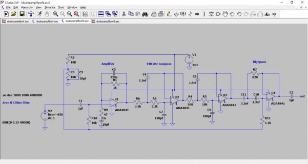

If we want the best of both worlds, we could probably try and build something like this.
I don't know if this is something one could do but this is the amplifier, followed by a two stage low pass filter to het a steeper filtering of the unwanted higher frequencies, and at the end we have a high pass filter. I tried to find values that give about the same results as the older amplifier.
These are te output gain curves to compare the older and newer filter. Yes, i also should have showed the same for the aetertech filter, but I did not store the circuit and it is near bedtime for me now.
I hope this starts the spam factory back up.
Edwin
I would decrease the values of C1 and C5 from 1uF to 10nF, as I suggested in #504. This would suppress low frequencies that for Bat frequencies are not at all of interest.
Play with a spice program to find the actual value of the HP cutoff frequency. I would aim for a 1-10 kHz HP corner frequency.
To reduce unwanted LF signals, I would start with reducing only the feedback shunt capacitor (C3 in post 503) to somewhere in the .47uF to .22uF range. You can further reduce C3 to .1uF to .05uF if necessary. All that is really important is to ensure LF sounds do not clip the preamp output (which would produce a large amount of higher frequency harmonics in the "desired passband").
Reducing C1 will affect noise performance, but could also be used to reduce LF performance if necessary. However, I'd try to get what is needed using only C3.
If a steeper than -6dB/octave HP filter is deemed necessary, I would stick with a single opamp unity gain second order filter. For best performance, the only place you want gain is at the preamp. As well, a multiple section HP filter is going to introduce additional noise and distortion.
If a HP filter is used, it should be inserted between the preamp and the LP filter.
