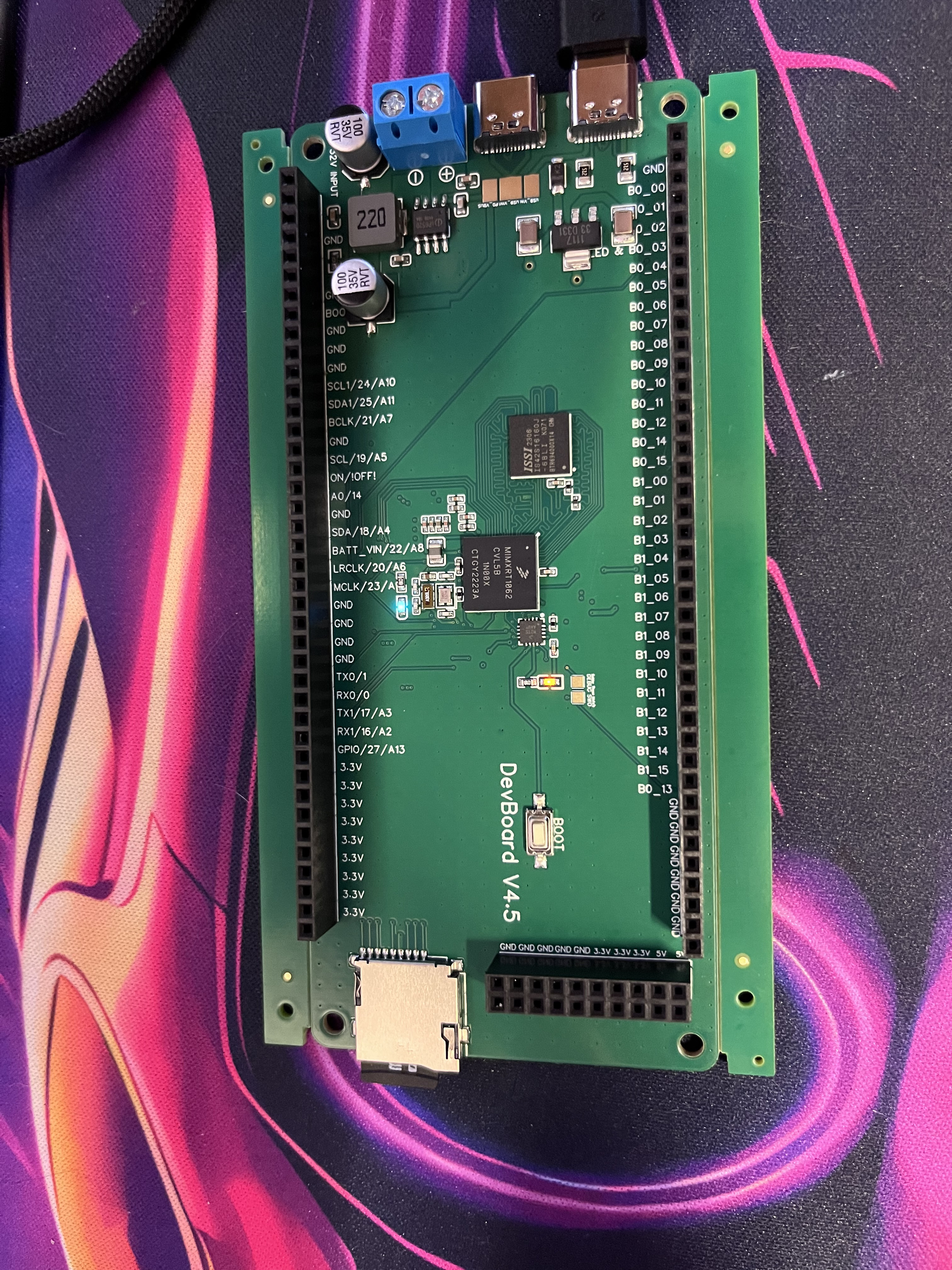

I want to get started with elcdif. That's next after cleaning up the Ra8876LiteTeensy library...
Testing the different cameras on the SDRAM board became problematic - not sure if wiring/connector issue but alot of problems we were seeing was with the wiring as @KurtE mentioned on the camera thread about wiring. So we decided to make a adapter board for the displays and camera. Should have it next week to make sure I didn't mess it up.
Was hoping you'd included the voltage regulators for the OV2640's additional requirements... you don't want to see the mess I've got with LM317s.
Just wondering, are you saying that on the current Devboard 4, that the 3.3v Voltage regulator is maybe to anemic to run some of the different devices that you have connected to it? And that maybe we should add another one to connect the devices, such as displays and cameras to?
Hopefully the Devboard 5 will have a stronger one. On some of my own more recent boards, I ended up using one that is similar (different package) than Sparkfun used on their ATP micromod board, which puts out 1Amp.
No. The OV2460 runs off three different voltages: 2.8V for the analog sensors, 1.2V for the core and 3.3V for the I/O portion. The ArduCam boards have two regulators on the back to generate the lower voltages from 3.3V but I just have the camera module directly connected to a breakout board.
I found an Arduino 8080 parallel IF used for the RA8875 (same 8080 interface as RA8876) that uses 74LV245's as buffers for the Due and possibly the Mega 2560 found here. I am going to order up some of these chips if I don't have any left and see what the results are with the dev board. I am kinda convince that this is the issue based on the fact that the T41 handles the highest reliable speeds in both 8-bit and 16-bit mode and has the shortest trace distance between the edge connectors and the MCU. The MicroMod and dev board are pretty much the same in usable speed settings. Just to satisfy my curiosity :D
One question did you bring out the csi pins?
I did not bring out any special ports. All that was done was SDCARD and USB-PD. But ofc we can keep going and make a gen5 that has more stuff. But it needs coordinating, Rezo and KurtE together could make a full pin mapping, that would be ideal. Then I just follow that. It will minimize mistakes.
Regarding power supply on the board, anything can be added. What voltages and amps are needed? I have several tested circuits that are reliable!
For the 4.5 (facelift) there’s USB-PD that can do max 3A. Will this suffice?
I got 10pcs of the 4.5 made.

I’ll make a gen5 of this board, all I need from you is a complete list of pins. I know you’re very good with the pin stuff since you made those PDF’s on Git.
The SD-Card uses the SDIO pins yes.
