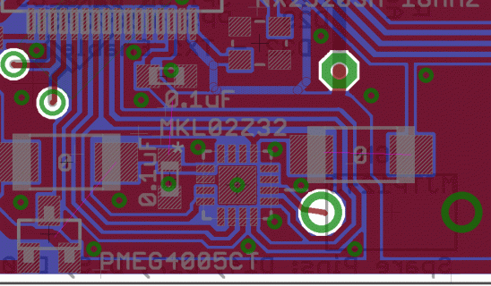

Thank you so much. I will revise the next turn of the board for the new chips. Progress has been so slow.... (argh!)

Spent some time this AM to design a new board using the MK20 and the MKL02. Got it down to 2 jumpers/0 Ohm resistors/or vias to make it work on a 2 layer board.
I will be releasing a new set of libraries shortly with all bootloader chips (MiniTAN and MKL02). I have yet to put together the TQFP package for the MKL02, however..

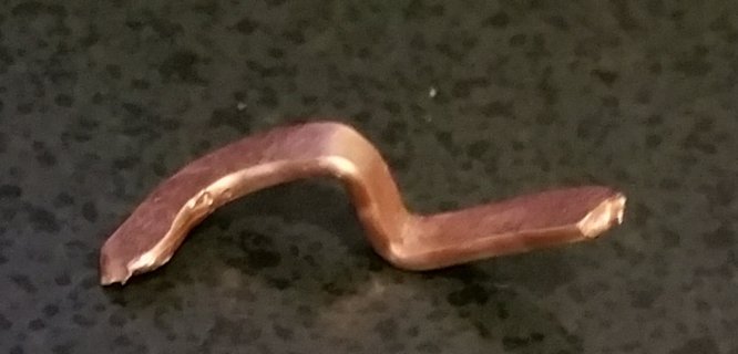

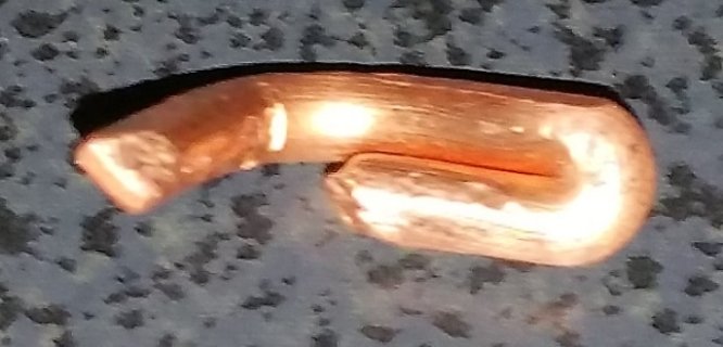

How about a topside heat sink? 14ga(2mm^2) copper wire flattened (1x3mm) and shaped to cross over the back edge of the USB shell? Thermal paste on chip contact and soldered to shell should be stable and low profile.

This is a heat sink, not a heat pipe. A tiny heat pipe for this application would be awesome, though I don't know where we'd get them.
A heat pipe is hollow and has contents that change phase. Also the interior is typically shaped to provide increased surface area over a simple pipe either by grooves or sintered metal power.
Dutifully corrected the nomenclature. My concern was if there was any risk in the design - and worth the trouble? With plastic shell and no nearby things to short, paste to mate and fill voids - don't want to make an antenna or such other issues. The sink mass seems significant enough and cheap/easy - especially if the usb shell gets involved. MarkII design rather than the vertical bend, the height difference might be better done with a flat top and the wire folded under to come down to the chip top. Flattened and shaped for contact - solder the side of bent under end to make sure the full bent piece won't fall free.
